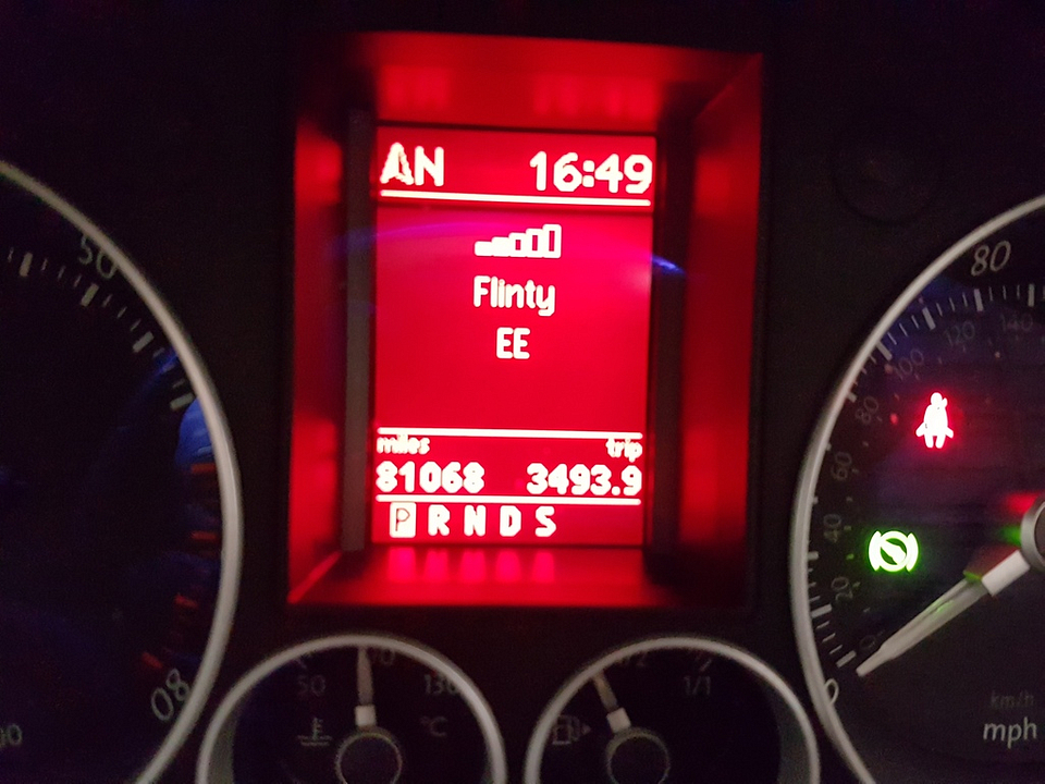

Have a rns510 with the blue tooth module and the bt polar box installed.. The polar allows the phone book calls etc in the dashboard clocks and it also stops battery drain and allows blue tooth streaming
