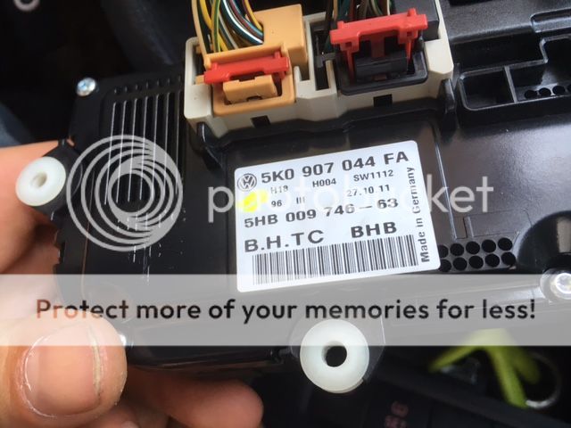

i have done this mode, and it looks perfect, everything works ok, except the AC.
I changed pin 16 to pin 20,
press the ac and the third button until they start flashing,
but when i pres the ac and rear heating window nothing happens.
and the ac is still not working.
Any ideas?
this is my control unit,
the car is 06 GT diesel
Offline The Red Warrior
  • Posts: 282
Re: MK6 Climate Control
« Reply #17 on: June 26, 2016, 06:21:49 am »
Any ideas?
When I installed mine recently I noticed that the car has to be on (engine running) for the rear window demister to work.
Can't help you with the AC though.
Any ideas?
You'll need to get a newer ECU and get the data cloned from your old ECU into new ECU
Been there.... didn't believe it, but it's true!
