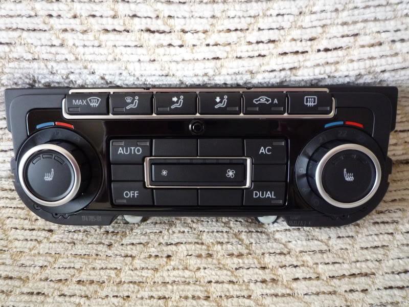

Secondly which unit should I be looking at?  have dual climate now in my MK5 but all the ones I see only have 1 heater knob so guessing this isn't right, then the ones I see with 2 have buttons for heated seats which I don't have. Is it hard to come across the exact part I need? Any pictures of the unit I should be looking at? Part Numbers etc?

Ok they do make them which is good (if this is the right one?)
Part number: 5K0 907 044BC

Betty its one of them things to do with the right panel to the right ECU,
It is all to do with the ECU, my 05 TDI was perfect and worked with all the panels but VW updated the ECU on a recall and messed the communications between the ECU and the climate panel, none of the panels would work then... :surprised: but a forum member came to my rescue and reset the ECU...every thing works now :happy2:
5K0 907 044BC works fine as long has the ECU is the right one :happy2:

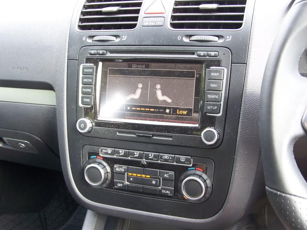

Jedi the appearance is debatable, I find it more pleasing to the eye than the mk5 climate, it fits in with the RNS510 and looks cleaner...also rather than some nasty looking readouts it comes up on the RNS510 screen.

I find "5K0 907 044 N"
which is:
 "5K0 907 044-60"
which is:
and
5K0907044 BT
which is:
Which one is the right for me?
Thanks!
Offline Eddie-NL
  • Trader - 2014
  • -Receive: 298
  • Posts: 2639
Re: MK6 Climate Control
« Reply #10 on: December 19, 2011, 11:11:02 am »
Buy one which has heated seats dials on, the N version is a US part and the temperature next to the dial is in Fahrenheit but it will display on the RNS/RCD510 in Celius. The N version is a older panel so you won't have the Missing message fault which newer panels have.
