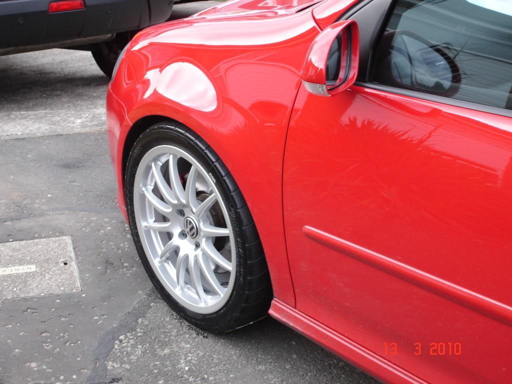

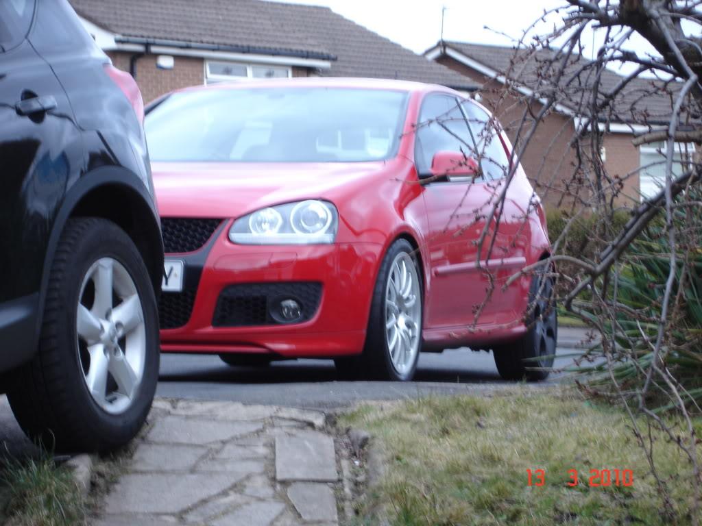

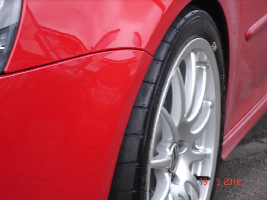

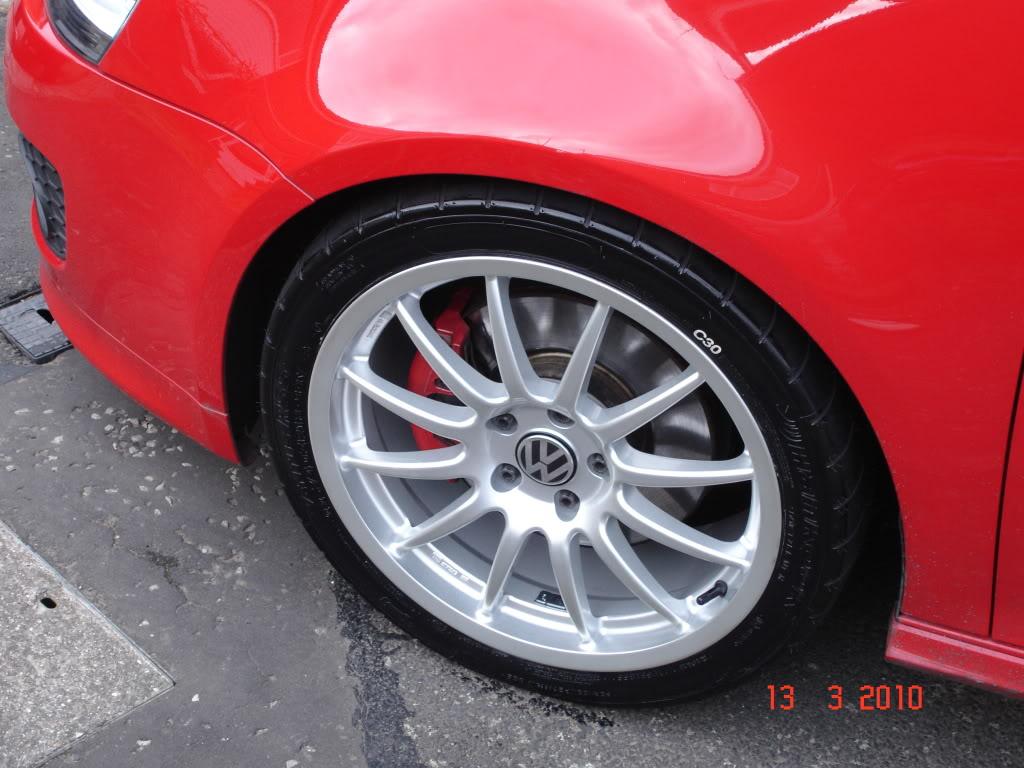

I swapped the vw centre caps too, wasn't sure whether they would fit but they do which is a bonus  :happy2:
Here they are

nice, they fill the arches spot-on, just assumed you would be goin for black, can't wait to see it side on with all 4 wheels on :happy2:

I had thought about black but fancied a change from the black monza's... Can't wait to get the rears on, was planning on still running the 10mm spacers, is there likely to be a issue with this?

you won't need them pal the TD's are 8" wide and 45 et, std is 7.5" wide 51 et, so with the TD's it like running a 12mm spacer with the std wheels :happy2:
