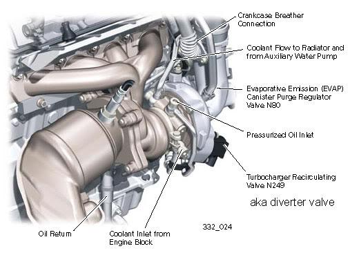

« Reply #24 on: March 22, 2010, 12:31:46 pm »
here is a diagram showing where its located mate
you will have to jack car up, put on stands then get under to do it. I tried to get mine off when i had a spare 15mins but due to location i found it hard
its held on by 3 bolts, not sure if its a torx or what size mate
so 3 bolts and undo the plug for the wire and its off
hope this helps
