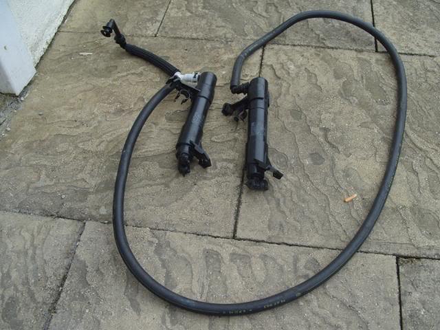

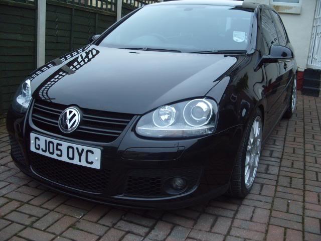

This has really been done on a very very tight budget by me Mr Scrooge :happy2: The headlights cost me £300 with the bulbs, ballasts and every thing else.
I also bought the auto leveling but got the parts minus the loom from Ebay.DE the headlight range module is an 8P0 unit from an Audi A3 and the sensors are from the Golf,
Every thing else washer jets and hose I got off ebay.co.uk for £11 :grin: :happy2: that included the 4 bumper mouldings, 2 Jets and the full hose right to the pump.

No Xenons
Xenons
Xenons without auto leveling or washers
Washer Jets
All installed with DRL's on

In all its cost me about £550-£600 including the 2 looms from Kufatec for the washers and auto leveling

excellent work, did the washers not need a new pump for the washer container, or were they just bolt on the existing system??  :congrats:

Cheers Jake :happy2: the system needed an extra pump for the headlight washers but there is a space in the existing bottle, it just needed an hole for the pump and another for the level sensor cutting out.
I bought the kufatec washer loom which incorporates the pump and washer level sensor in one.
I could do this stuff all day long,  Infact I fitted Golfmans heated washer jets on Monday and before that did the auto leveling and washers in a day all in.
Darren

Nath any time mate, very easy to do the only bit I still hate doing is splicing into the can bus very restricted access where the can buc module is,  I need to find somewhere else I can splice into where I have better access.

How did you get the DRL's to work? I didn't think they could be enabled if retrofitted? Is it to do with the levelers?  :happy2:
