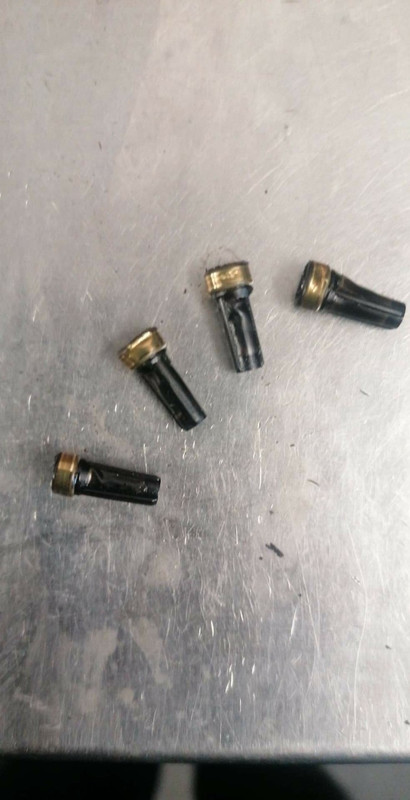

Stage 1 – Find the damage
The spark plugs were removed to find this:
This meant there must have been some sort of damage to pistons / cylinder head as something had hit this plug, so the head was removed to find this:
Ian from Diverse Rides gave me some options using some of my pre-reqs I had already discussed. He gave me just a straightforward top end rebuild cost, new head, 1x piston etc… this would have been the cheaper / most cost-effective option. We discussed if I wanted to make the engine more efficient / reliable and what modifications were needed for this. I chose to make the engine more reliable and stronger, so this sort of thing does not happen again. I was happy to pay a little more knowing it would last and not have these issues again. Ian set out / recommended what parts were required to complete the job gave me a quote for labour then we set a date to move the Edition 30 to his premises to start work. I was so impressed with his knowledge & friendly approach I started to feel excited at the prospect of the ultimate GTI 😊

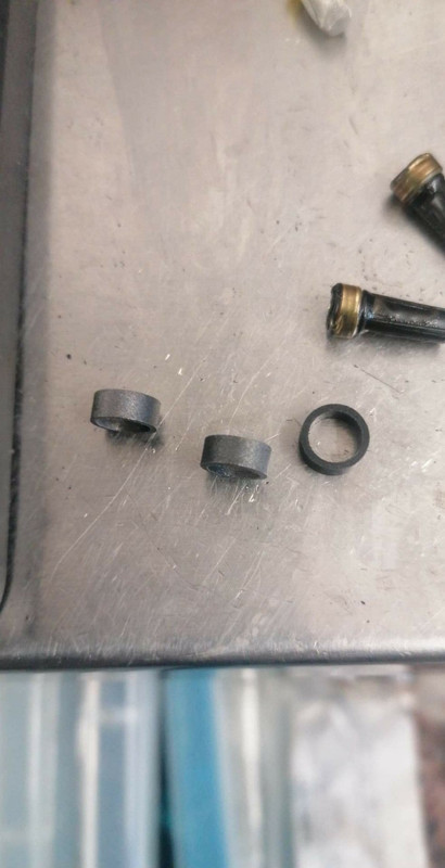

As a courtesy / compensation for having to leave the car with them, Rtech removed my injectors and completed a full injector clean & upgraded the filter baskets & graphite seals for me:
Here is the before injector results
You can see which Cylinders had the issues before the rebuild.
After injector clean, much more stable / consistent results

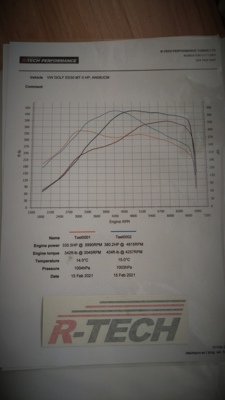

Then Nikki completed the Stage 2+ remap, here are the stats
Rolling road before map with the rebuild & added modifications the car made a healthy 335.5Bhp & 342Ft-lb, then Nikki went to work tweaking & tuning the GTI.
Final Stage 2+ tuning results  :popcornsoda:
380.2Bhp & 434Ft-lb  :jumping:

Judging by pictures. Looks like the runner flaps have failed. Cylinder 1 had a chunk in combustion chamber and destroyed everything.

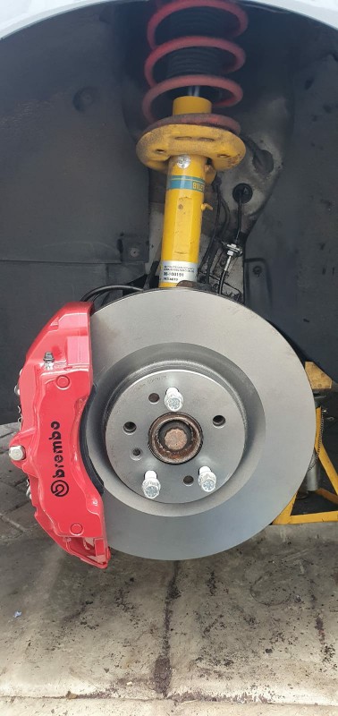

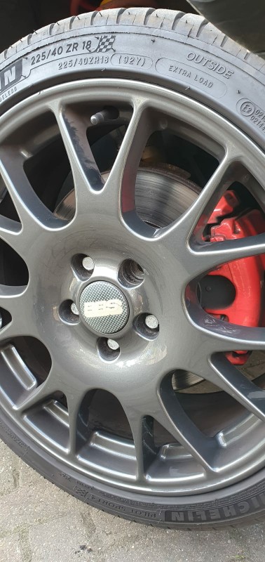

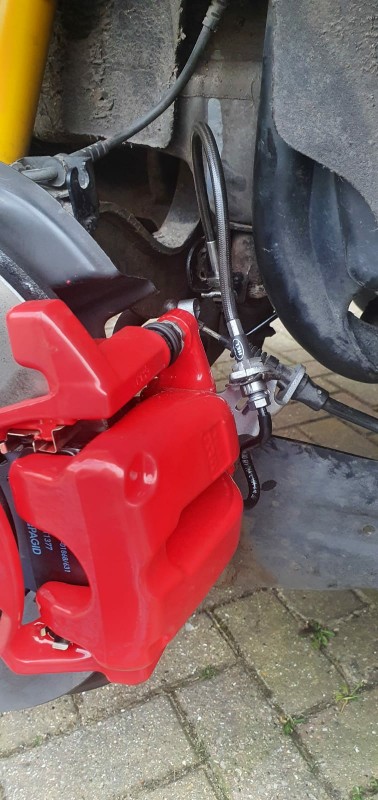

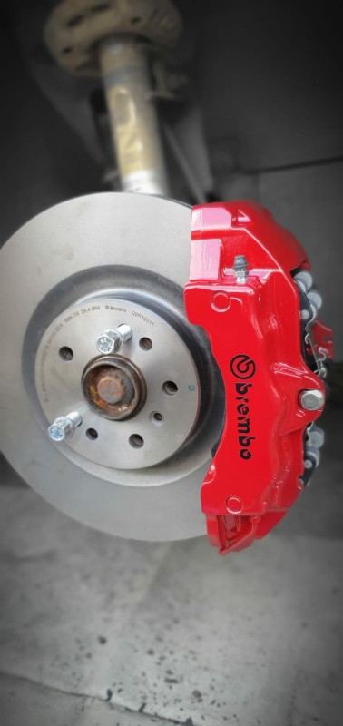

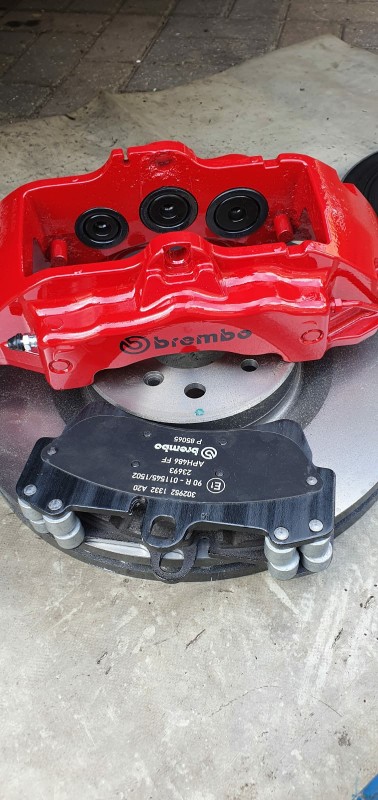

Big Brake conversion
After Rtech mapped the edition 30 Stage 2+ one of the health check notes was the standard Edition 30 brake setup. These were original running old pads & discs so faded very fast at Stage 2+ speeds.  :grin:
So after some researched i sourced the below items to improve the braking of my 380bhp GTI:
All work completed by the wizard @ Diverse Rides.  :happy2:
18z Brembo Calipers
350mm Brembo discs
Brembo pads
Hel Braided front & rear Lines
Rear R32 calipers
310mm Brembo discs
Rear Pagid pads
Rear connecting pipes
Dot 5 Pagid brake fluid

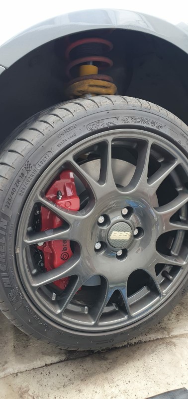

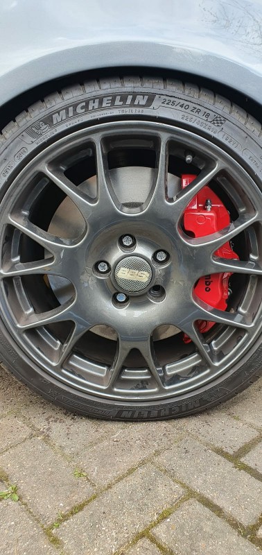

Before
After
Have now bedded in the brakes and they feel nice and strong, full respect to Ian Tamkin for his thought process & logical brain to get these fitted behind the stock Edition 30 wheels. He had to use the 16mm spacers on the front which are soon to be replaced with 15mm which will make the wheel sit perfect within the wheel arch and the 16mm will then be fitted to the rear.
Thanks Diverse Rides  :congrats: :driver:
