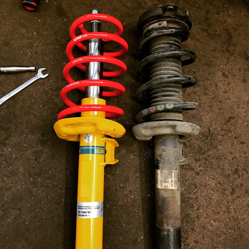

Hi if you have Vw original springs installed at present could you check the colour coding for me? What colour are the 4 dabs on spring?
Also what was included in the suspension kit, looks nice?
Thanks
Max
Here you go bud

Odd, cause mine doesn’t sit anything like youve described, doesn’t look much different than it was stock, in fact I don’t think it’s dropped more than 10mm! and as for comfort it feels firm but I certainly wouldn’t refer to it as uncomfortable in any way! I was surprised as I expected it to be really hard! I see there’s a few different b12 sportline kits listed for the GTI, my front shocks are the ones listed by awesome but other suppliers seem to list a different part number!
Ahwell, I’m pleasantly surpised!
I was umming and arring saving money and buying a vogtland kit before buying this b12 kit, I’m glad I didn’t as I mot’d a Leon last week that had the vogtland kit and that did feel bloody awful!

They will drop slightly after a few miles. Mine does sit lower at the front compared to the standard dampers and H&R springs I took off. Overall though the B12 kit was a massive improvement on my ED30 and probably the best mod I’ve done so far.

Also for info, with the B4 and Eibachs there's very little drop on the front but much more on the back, to the point I need my headlight alignment sorting as they're pointing up a bit too much for my liking. May just be the fact I replaced the units and put better bulbs in at the same time and I'm just noticing it though.
