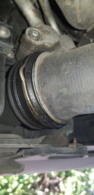

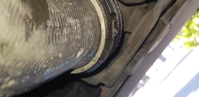

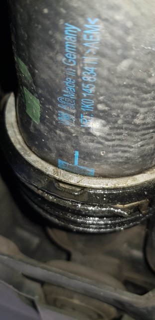

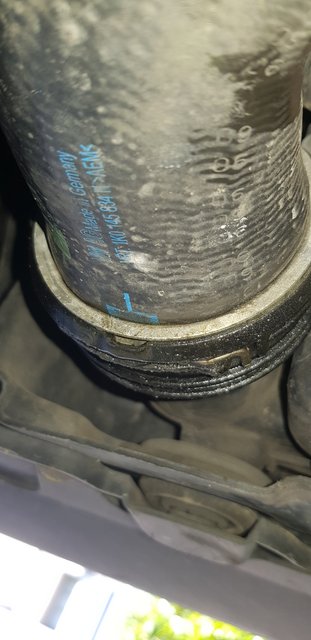

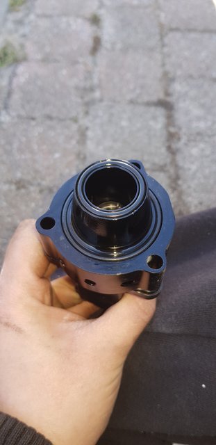

Hi everyone, i search a litle bit but nothing find, i have a strange noise from turbo or not, when i press the gas, in stationary or (while i drive i cant hear it) have a tap noise like something close hard. I will post a video too. And also i have some oil at intercooler pipe and at my diverter valve adapter too.

The oil is normal at the intercooler pipes.

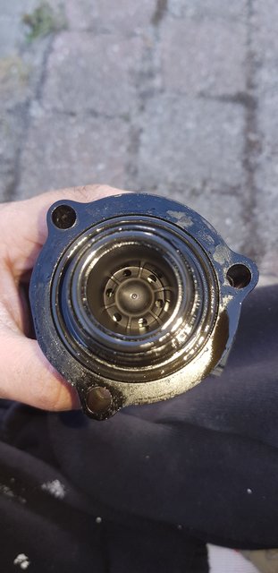

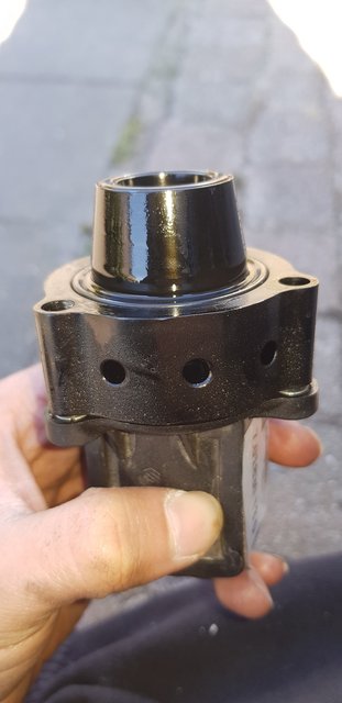

Remove the diveter valve and check its not torn.

I think like this too but when i remove the dv there was nothing special everything was in his place. And its a revision D.

Id recommend getting the car smoke tested if your DV is intact.

I will search but its hard to find a garage with smoke test. Anyone with orher ideas?
