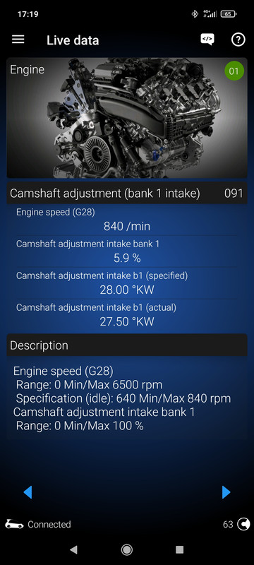

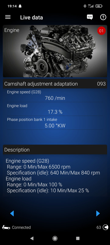

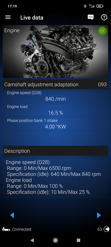

Anyway new chain tentioner gone into measuring block 93 and it's reading +4 apparently it should be 0 to -2 at most. Images below
My cam phase adjustment 1 requested is 28 and actual is 27-27.50 image below
Thanks

Was car fully up to temp when you checked everything
It's even worse now 5

I believe you are right, as I made a note against my similar snapshot last year (in order to monitor), stating it can't be more than +/- 4 or 5, otherwise urgently replace tensioner & chain!

If the timing was out the camshaft adjustment specified and actual would be way out of line and they look ok , maybe it’s a vvt problem possibly worn gear

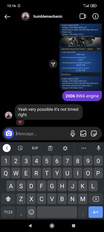

Charles the Humble mechanic Vag master technician (all over YouTube too) said it's possible it's not timed right. Still waiting to get it back to mechanic to look into it.
I've only owned tfsi done a good few chains and everytime I put a new one on it's sitting at 0 or -2
I remember my old GTi was at 4 and both phase readings where 28° we put s new chain and was sitting at 0 nice.
Definatly something wrong with the chain I recon. I will keep you all updated once it's been stripped again

Yes humble mechanic seems a decent bloke I watch a lot of his stuff , It’s a strange one as everything in that pic you’ve sent to him is spot on for what it should be, I’m pretty sure if the timing was out then Intake b1 (actual) would be reading a different number to the specified.
Iv seen others with similar readings after changing chains and bank 93 is reading 4-5 +/- , Iv seen a post on face book where somebody’s chain was reading -8 so they got it changed and it only went to -6 all timing was perfect as well.

The difference between 0 to +4KW isn't even a tooth out from memory, but to be sure, count how many teeth are on the cam sprockets vs the crank and that will give you degrees per tooth.  From my own calcs years ago, 4KW (or degrees) isn't even half a tooth. I think I arrived at + or - 12KW if it was a tooth out, but don't quote me.
All of this assumes the base timing was set correctly on the last cam belt change, but again, if the cambelt was a tooth off, you'd know about it.  And the cambelt is something a 5 year old could do, so no excuses for that.
You are spot on about people relying on the cam lock tool.  Big no no.  You actually need to tweak the inlet cam anti-clockwise a tiny bit (with the lock tool in place) to get the correct chain tension across the two cams, and there's even a special VW tool for that.  Again, it's not by a massive amount and the VVT will automatically compensate for any slight timing drift, but you still need to set the static timing as near as dammit upon initial assembly.
Of more concern is the smoke.  Is it blue/white oil smoke?  Does it smoke pulling away after a period of idling in traffic?  Is it worse when hot?  Could be valve guides or turbo. How many miles on it? Is the PCV system up to snuff? No aftermarket deletes or anything?
The requested vs actual timing is always 0.5 off at idle.  Don't worry about that.  More importantly is the specified and actual mirror each other rapidly under load.  If you log the VVT channels, you should find it goes from 27KW down to nothing very quickly under hard load, and varies between 0 and 27 when driving.  So long as they match, you can outrule the timing and VVT operation.
If they don't, you normally get fault codes.  "Cam timing - set point not reached - over advanced/retarded", or "cam timing slow response".

If you have a phase position figure and the requested and actual on idle are 28/28 then the timing is fine.
