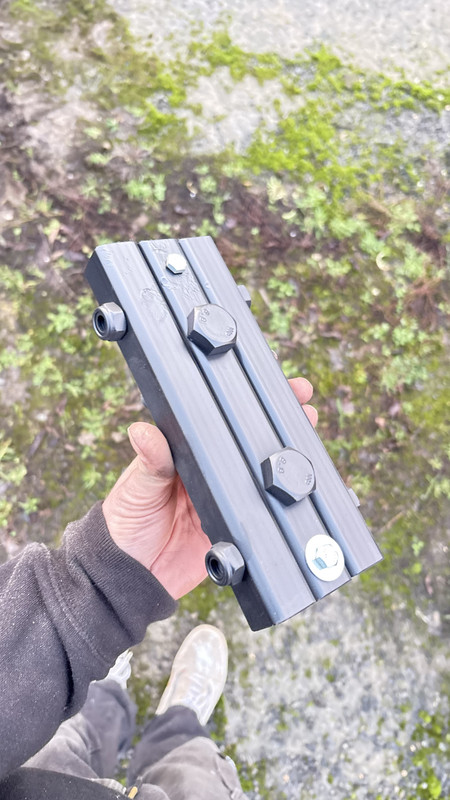

« Reply #5 on: December 16, 2025, 05:00:22 pm »
I hope this works🫡
Made with 25x25 metal piping instead👍
