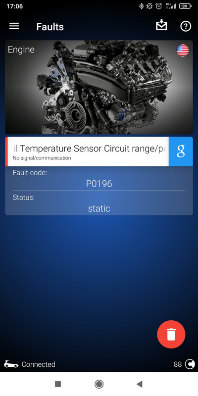

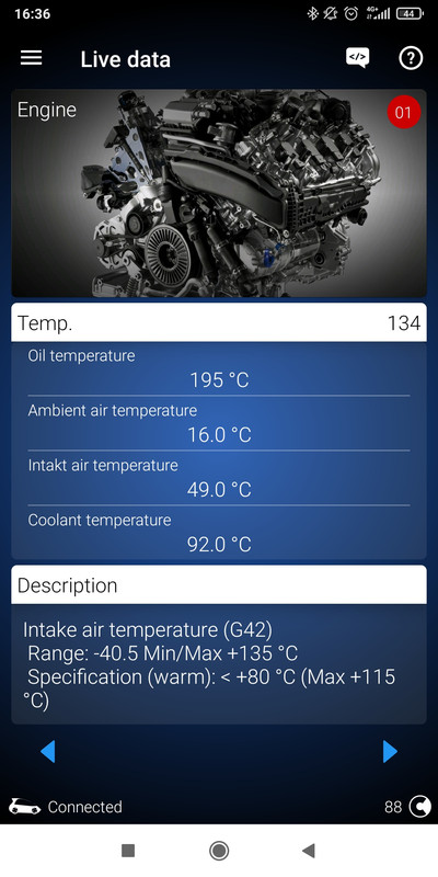

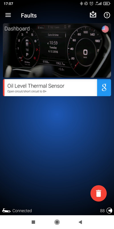

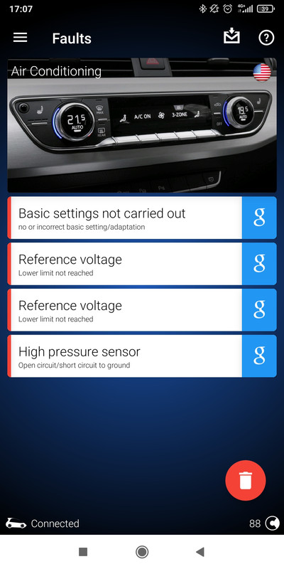

Hi looking for some urgent help if possible. I have a 2008 dsg gti (BWA) and looking for the correct fuse list as there are so many online. Basically I've replaced the ac pressure sensor and also replaced a 10a fuse that looked blown thinking it may be the AC fuse. Now I have loads of as faults and the climatronic has packed up altogether, also a 'oil sensor garage' has appeared on the dash and won't clear. Please tell me these are somehow linked! Any help much appreciated.

Sorted now thanks. Fuse 4 (5a) had blown. Upon replacing fans working again and oil sensor message gone from dash?!!
Quest for cold air con continues though :-(

Did you say the new pressure switch leaked?
Yes mate. But think we have made a cock up....when we took out the old switch there was no o ring, fitted the new one with o ring and that's when the codes came and climate shut down etc.
When I lifted the bonnet you could hear gas escaping. Fitted the old switch without o ring (as that's how it came off) but with hindsight we reckon the old o ring was still in so we put one on top of the other if you get what I mean, and it didn't seal properly!
