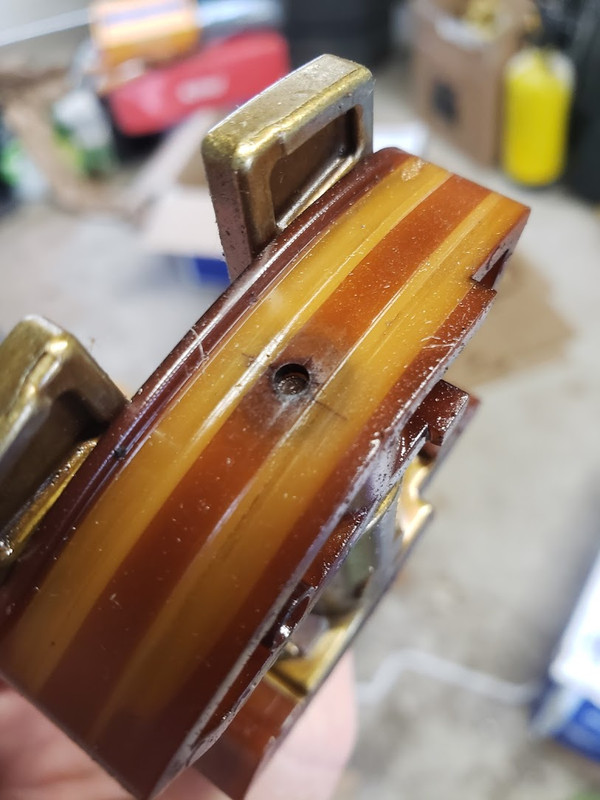

If you're like me and keep your cars for a decent length of time, I would always pay the extra "premium" up front in the purchase price that comes with a decent service history and proof its been looked after. Despite VW's desired image of reliability, I'm astonished at how high-maintenance these cars can be.
At that mileage, there's a whole bunch of things that I would want to see replaced. For example, I replaced my chain/tensioner at ~110,000 miles. The tensioner was thoroughly worn and had a hairline crack right where the piston sits:
Ultimately, everything wears out given enough usage so personally I'd avoid the potential for mechanical headaches and find something that at least has proof its been looked after.
You got to that in the nick of time  :happy2:
Judging by that varnishing, I'd say your engine has suffered the marketing crime that is long life servicing!
