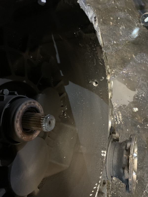

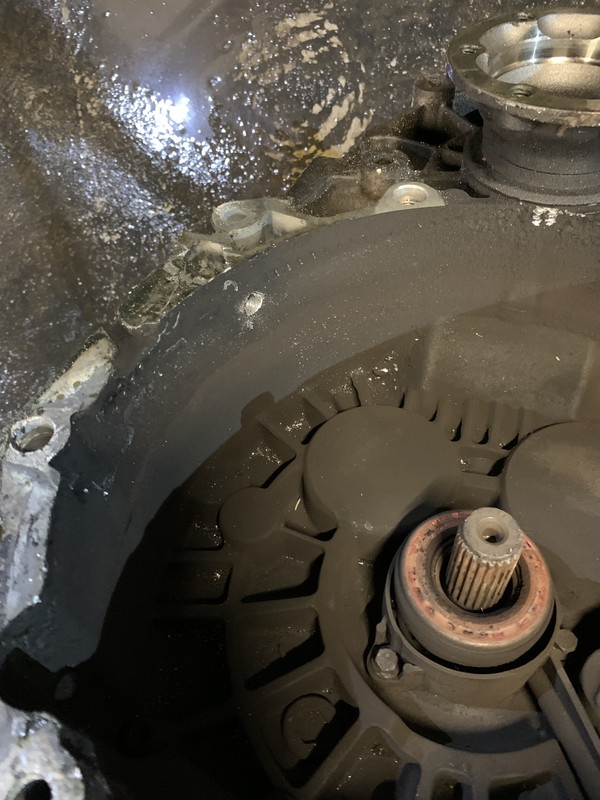

The engine was kept as one lump, engine gearbox with all ancillaries, which is the reason was mad confused..  :thinking: :thinking: Clearly we fudged something up with the install. It wasn’t turning by hand at all.
However it’s good news.  :drinking: And laughable. Learnt my lesson
Spent this evening removing the gearbox to inspect that maybe it could be gearbox related.
Wait for it …………
Mixed up the bolts on the dogbone mount, so the longer bolt was jammed into the flywheel stopping the engine from turning.
Just dreading getting the gearbox in now, such a pain removing.
Turned the engine by hand and free as a daisy.
Lesson learnt …. Don’t mix up your bolts  :doh: :doh: :doh:

Is there a hole in the bell housing there or has the longer bolt punched a hole through?
I have to admit I nearly did a similar thing recently when I changed my cambelt and got one of the old engine mounting bolts mixed up with the front dog bone bolt. Luckily I stopped and checked part way through screwing it in as I thought something wasn't right.
Exactly that mate. We punched a hole through with the longer 16m bolt. Think it was the excitement of getting the new engine in haha lost track of bolt locations :grin: :grin:
