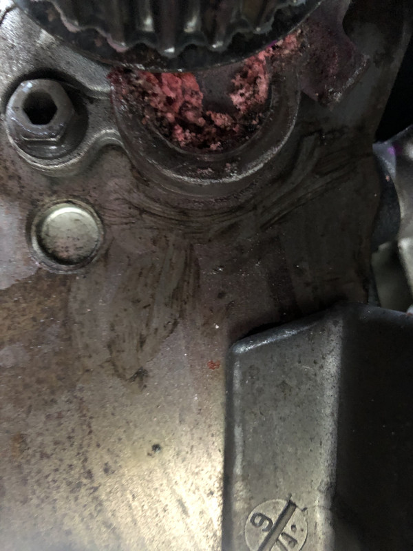

« Reply #2 on: September 13, 2021, 11:08:21 am »
I’ve just replaced my timing belt and wasn’t going to change the water pump, I had 1 in a box but though if it ain’t broke! Then I noticed some pink flakes on the crank pulley, the pump was leaking from the shaft, easy enough fix, pelican parts have great step by step guides.
