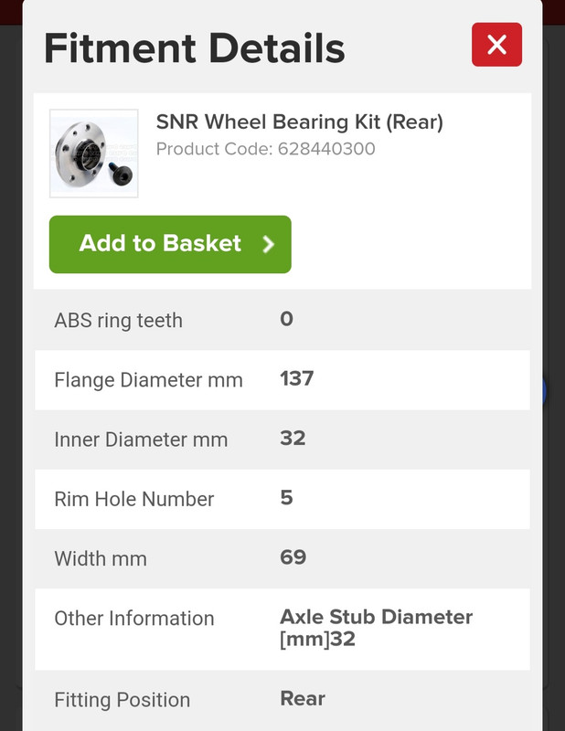

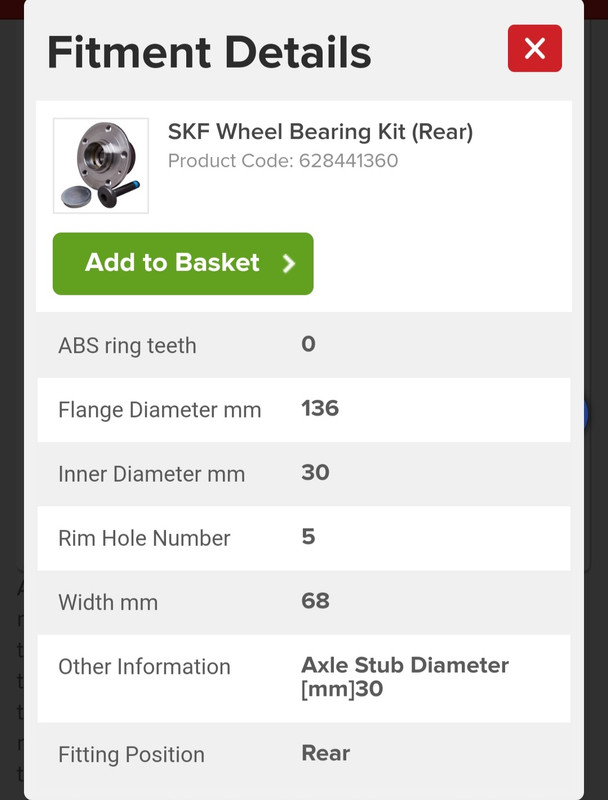

Getting a noise and a metallic rattle from NSR Wheel and can see black brake dust real bad on the wheel so thinking to replace the rear discs and pads (although they still look to have loads of meat on them).. or the wheen hub n bearings as I'm getting some rumble noises at speed.
Problem is eurocarparts shows 2 different sizes?

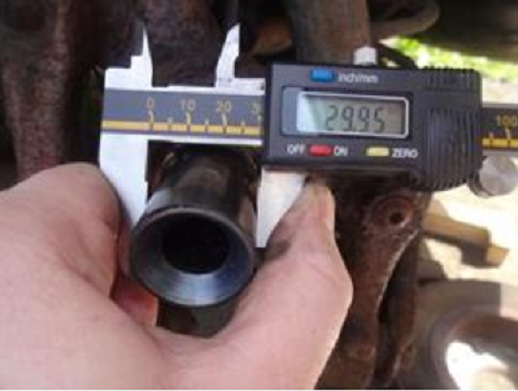

The best you can do is have a VW part center run your VIN and tell you which size it is. There was a build date change over from 30mm to 32mm as I understand it...with most being 30mm. If VW can't tell you which fits yours...then you may need to measure it upon removal. Which means, depending on your transportation needs, you may need to buy both sizes and return the one not needed. This one shown in the pic was fitted with a 30mm hub.

Thanks for the reply. I've bought a caliper Micrometer so will email vw first then if they don't know I will measure it. I have 2 cars so should be OK to measure it first.

My caliper Micrometer turned up so I could just whip the wheel off and measure the inside of the hub before buying. I'm tempted to buy a 30mm and it seems that's the normal.

You will need to take the bolt out to be able to measure the bore size - so prepare to channel your inner He-man / Hulk to undo and tighten it back up
