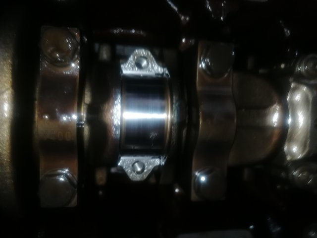

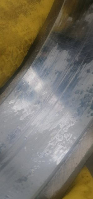

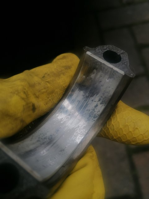

So I've just finished work on the car and am happy to report no up and down (vertical) play in the conrods. The crankshaft also looks clean (I only took off the piston 2 and 3 conrod caps).
Whereas the bearing looks a bit 'cloudy', I tried to use brake cleaner to clean them up, but I don't think it made a huge difference. I didn't want to risk scratching them so I didn't put much force in.
Luckily there's no pits in them from what I can see. Do I need to replace them?
Apologies for the photo quality, I must've had oil on the camera.
« Last Edit: October 13, 2021, 08:07:38 pm by OllieVRS »

If the bearings and journals are smooth and your finger nail doesn't catch in any of the scratches, it's safe to sling them back in.
How ever, as you've gone that deep into it, it might be worth checking the clearances with a plastigauge kit and stick new bearing shells in if necessary.

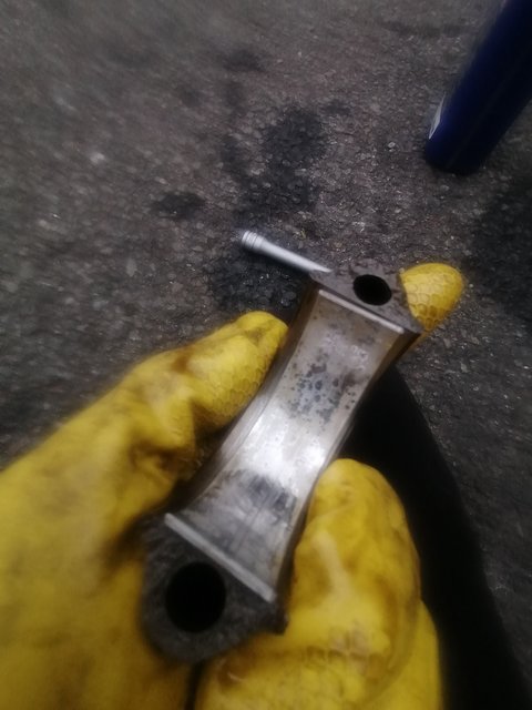

There is one bearing-long groove that does catch my nail on one of the two bearings.
On the advice of my mechanic friend I'm going to be replacing all of them, not just because of the groove or cloudiness but as a preventative measure too (and since I've already done all the work taking off the bottom of the engine).

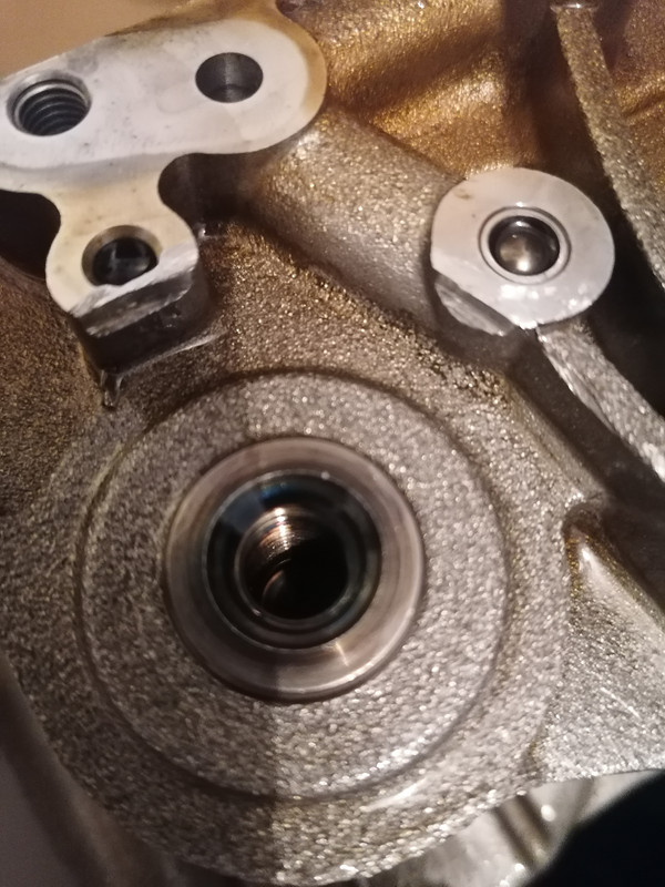

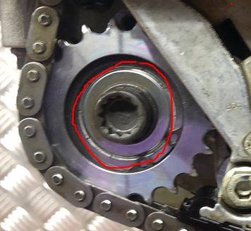

Just spotted a clue as to the car's history while looking at the oil pump to reference stretch bolts I needed for when I put it back.
I think one of the previous owners had the balance shaft sprocket bolt snap or come loose, as can been seen by the chip on the 'timing' hole on the top, also on the hole on the right and a slight chip below to the right of the right hole. This could also have been a source for the metal fillings in the sump I found when I dropped it for the first time.
Also, would anyone know if the bolt for the sprocket in question is a stretch bolt and what part number it is? It came off easier than a stretch bolt would, leading me to believe it isn't one or the previous person that put it in had reused it. Maybe I should reuse it but with some thread locker? I've attached a picture of the bolt I'm talking about (not my picture).

It is indeed a stretch bolt.  20nm + 90 degrees.  The 10 bolts that hold the pump to the block are also stretch bolts, 15nm + 90 degrees.
The upper left bolt hole looks suspiciously like a helicoil insert?
It does definitely look like someone has been in there before.
That bolt shearing off was actually a known issue on very early GTIs.  I don't know if VW ever addressed it but I do recall stories of VW having to replace the entire oil pump on several cars under warranty, and sometimes the whole engine.  It's a possibility that happened to yours. The bolt shearing off I mean.  In which case, reuse yours.
I can't find any info on the sprocket bolt, so you'll need to get one from the dealer unfortunately.  Any reference to that bolt online looks completely different, so I wouldn't trust the internet on that one.
Edit - had another look for the balance shaft sprocket bolt and can't find it.  The internet only lists the bolt for the oil pump sprocket.  Now that I remember, I did try and get that bolt last year when I suspected my balance shafts were rattling....and I'm pretty sure the parts guy said it only comes with the whole pump/balancer assembly, and not available on it's own.

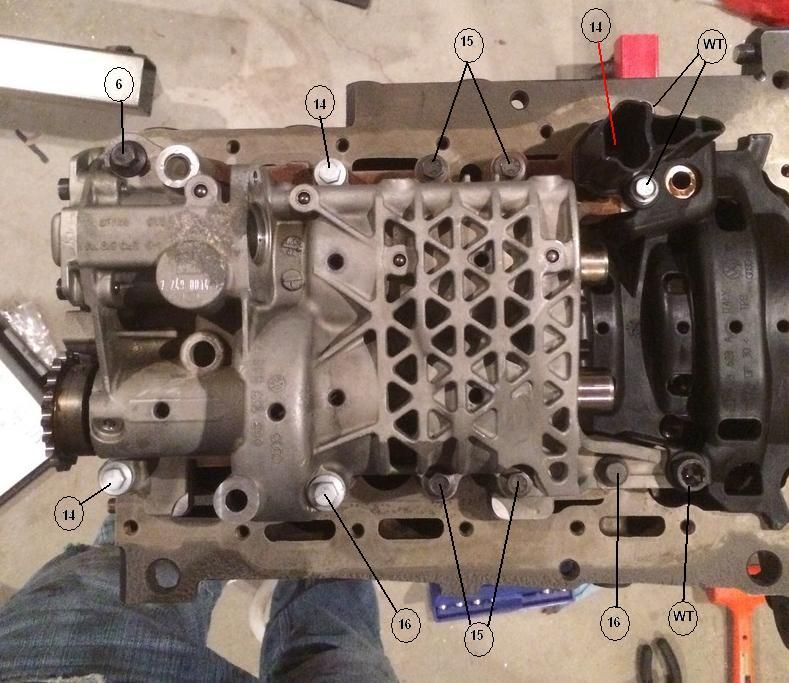

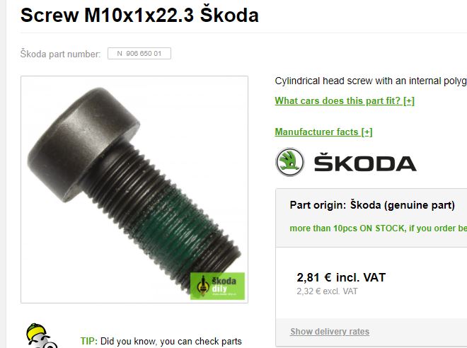

Called Skoda earlier this morning and have ordered 4 pairs of big end bearings for €46, and I confirmed with the guy my car was coming up as an FSI with a BWA engine on their system.

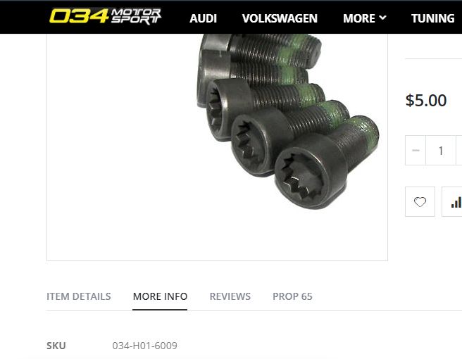

I also think I have found the bolt for the oil pump balance shaft. I used another forum's findings of the bolt being an M10x22mm (and from my findings uses a size 12 spline). It's a flywheel bolt and it comes up under two numbers: N90665001 and 034-H01-6009 , where the latter number seems to be specific to the 1.8t engine. I'm going to order two of the first number from the website in the last screenshot, so I have a spare in case I ever need to take the oil pump off again. EDIT: Have just measured my bolt, and it is indeed M10x22(.3)mm, and says 12.9 (grade) on the bottom. EDIT: THIS IS THE WRONG BOLT, I HAVE FOUND OUT THE HARD WAY
As for the oil pump to block bolts I found a post here on Audizine (https://www.audizine.com/forum/showthread.php/680111-So-you-want-to-build-your-engine…-Well-here’s-how-to-do-it/page2) stating the different bolt numbers so I'm going to repost them here if anyone ever needs them. The Skoda dealer only had the bolts starting with WHT and were about 5 euro a piece, so I'm only ordered the first WHT bolt from them as it's near impossible to buy it online in the EU.
Quote
Set it down on the locating bushings & tap it down until it is seated. You want to use new bolts for this guy as they are stretch bolts & should not be reused, especially if you are retaining the balance shafts like I am. I have numbered the bolts to coincide with the ETKA part diagram that Charles.waite provided me in a different thread. (The silver bolt labeled as #16 is actually #17. The black #16 bolt is correct.)
Part numbers
#6 – WHT 000 360 A
#14 – N 911 495 01
#15 – WHT 000 006
#16 – N911 496 01
#17 – N104 305 02
Torque all of these bolts to 15 Nm or about 11 ft-lbs plus an additional 1/4 turn.

I have attached some pictures of the used bolt (bottom) and the new one and where it goes in the oil pump, in case anyone finds these useful or knows anything about the exact function of it.
Close up of the where I think the oil enters/leaves the pump via the bolt:
Here's a picture of the oil pump and my friend pointing to where the bolt we found in the sump had fallen out off. I doubt the bolt that had fallen out had anything to do with the low oil pressure.
But this picture is also a good reference as to the position of the WHT 000 360 A or B bolt and its positional relevance to the oil pump mechanism itself.
