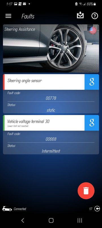

07' FSI won't turn over, obdeleven giving TONS of codes, PLEASE HELP!
October 18, 2021, 02:09:20 am »
My 07' WILL NOT start, it will try and turn over but just refuses to start! I'm to my wit's end and am so very close to giving up on it and getting rid of the headache. I ran my obdeleven and got a grip of codes which I am attaching screenshots of. If anyone can PLEASE help me get this better figured out so I can resurrect the Nazi bitch and keep her like I would prefer to do over anything!

It’s going to be the battery and/or a fault with the wiring to it. Terminal 30 is always the clue to that.

Terminal 15 is ignition switch and/or fuses or relay. First thing I would be doing is check each fuse with a test meter on the end of the dash panel (drivers side) then check them around the battery too.
