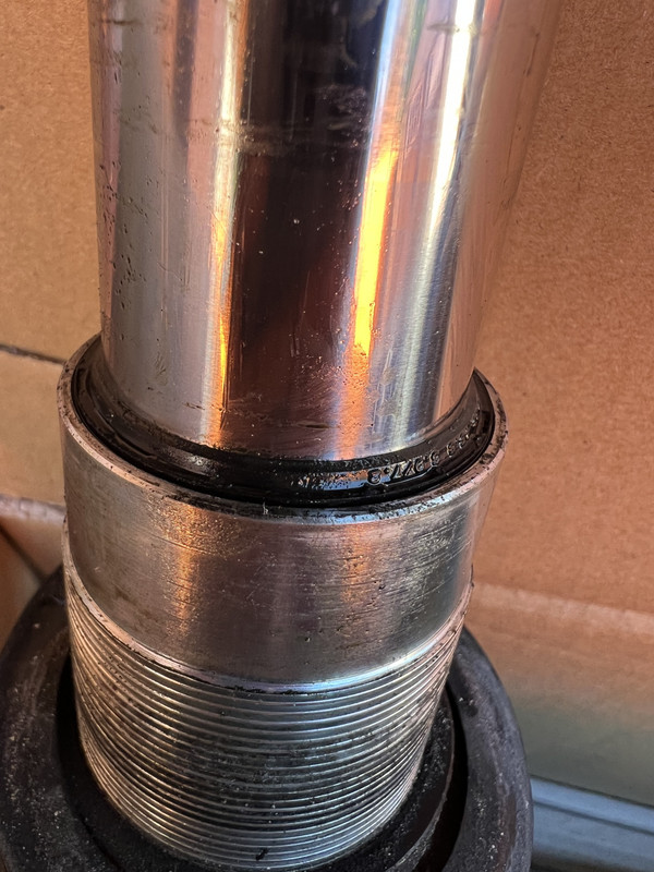

so now I'm pretty sure my coil overs are blown....

Borked dampers can certainly cause numb steering and sh1te handling.  Wasn't going to go down that avenue as I assumed they were new. Are they H&R comforts?  Can't see the pics as I'm at work.
they're H&R Ultra Lows, I've had them on for 1 year, I reached out to them with the pics and this is what they replied: "This grease is nothing to worry about, residual is somewhat common. I would get some brake parts cleaner and rinse it out and wipe it clean. Drive for a while and keep an eye on it. Let me know if things worsen, we can look into it further."
I did tell them the grease seems to be coming out of the seals, but they’re saying it’s normal 😐 🤷🏽‍♂️

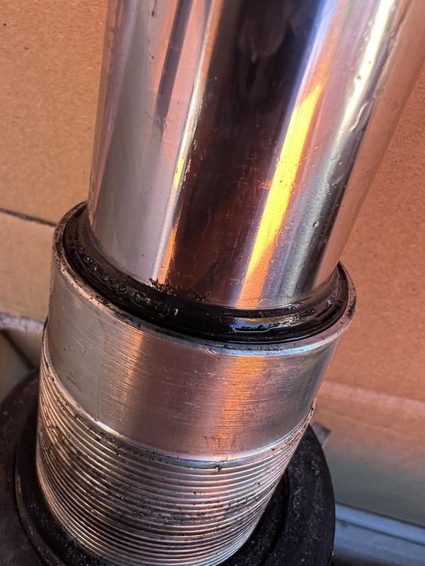

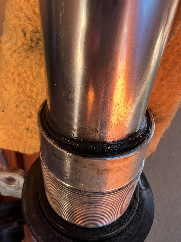

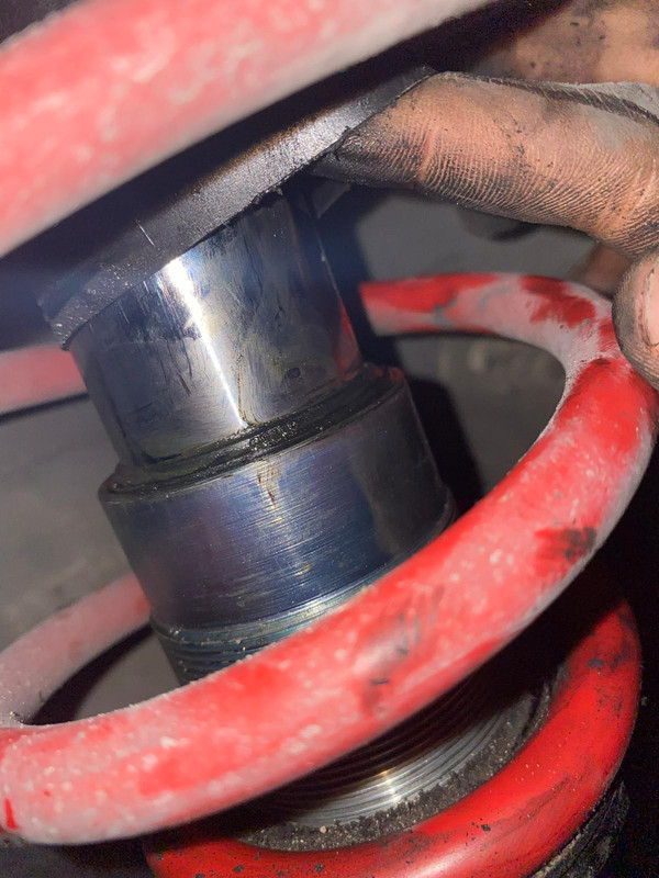

Hey guys, I know it’s been a while but recently I decided to swap my coilovers, after taking the old ones out I took some new photos, both front struts were covered in oil, under the dust boots and around the seals close to the threads there was oil/fluid. I have spoken to H&R and they say that’s normal for there to be some residual and if they were actually leaking oil they would be doing so through a weep hole at the very bottom of the unit since these are inverted monotube struts. Has anyone here who’s had these type of coils before seen anything like this?

I'll look at the pics later but I had H&R comforts on my Corrado many moons ago, and they blew after only 2 years' use.  I knew something wasn't right as the ride became very crashy, torque steer got worse, steering twitch got worse, tramlining got worse etc etc.  Just nasty and vague to drive in general.  Sure enough, once removed for inspection, they were wet with oil.
I don't know if they still are, but H&Rs monotubes were actually Bilstein B14s with their own springs.
I hate to say it, but monotubes aren't the longest lasting of dampers, but in any case..... there should never be oil leaking from a damper, not from any part of it.  Weep hole at the bottom?  WTF??? It's not a water pump with a bearing failure relief hole. Oil is the guts of a damper. It's definitely not normal to leak it away!
Anyway, if I confirm your pictures are the same as mine were later on, they've definitely blown.  It sounds like they're fobbing you off.

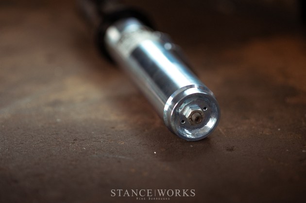

yeah I've found it odd too, supposedly...this is where they would be leaking from if they were defective according to H&R:
since the anatomy of the strut is inverted to that of a standard monotube, the shock absorber is placed downward, hence the pressure is generated towards the bottom.

Yeah Bilstein would know for sure, but sounds strange.  I've used in the past.....H&Rs, B16s, Ohlins DFV and not seen a special blow off hole on any of them!
That explanation just doesn't sit right with me as it implies the damper is designed to fail, and indeed expected to.....in some sudden and catastrophic way.  Very odd.

Just seen the pics and yep, that is exactly what my H&Rs looked like when they went.  As they were out of warranty, I got the middle finger from H&R.
