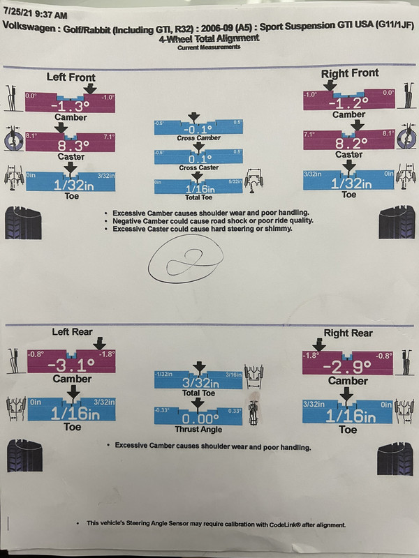

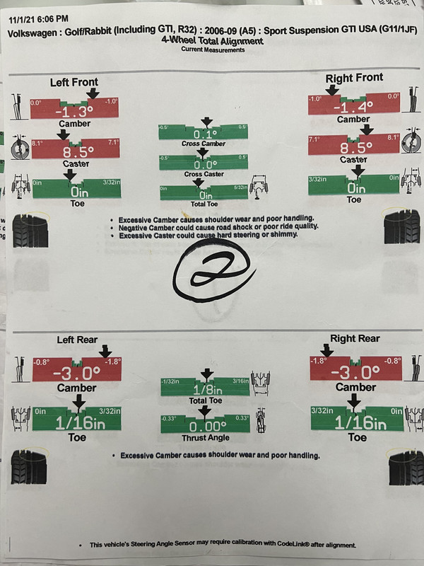

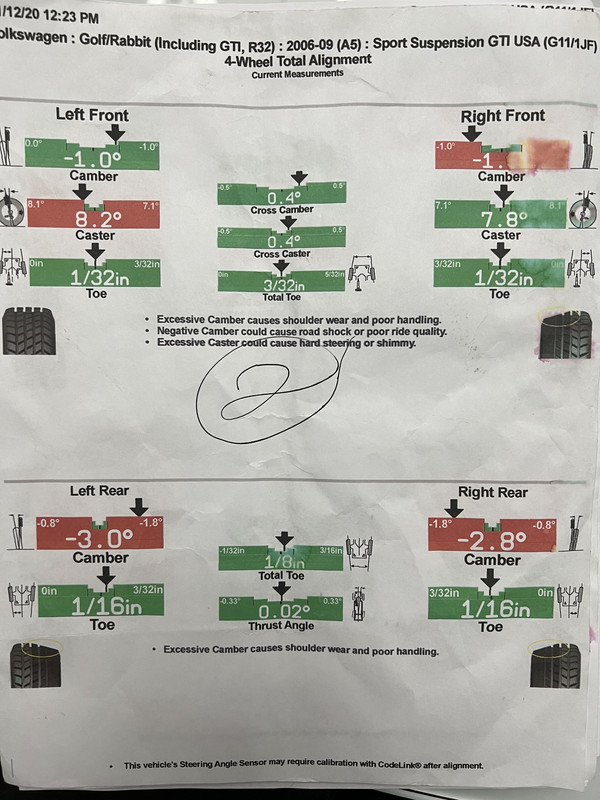

I have done 4 alignments since I installed them a year ago ( subframe has had to come off multiple times because of clutch swap, sway bar, etc)
On my most recent alignment, which was done this month, I asked for the front toe to be set to 0 degrees just to see if this would make it any better, it didn’t.
Im attaching the printouts of all the alignments I’ve had (last one is the most recent one) :
I have also tried increasing the tyre pressure to like 42 psi and even though it gets a little better, it doesn’t completely get rid of it, my other problem with having tyre pressure set that high is that the ride becomes horrible, too stiff and bouncy, not ideal for daily driving.
 Did try to raise the car a bit too, didn’t make a difference.
The steering column shaft doesn’t have any play in it either, I have checked that too.
