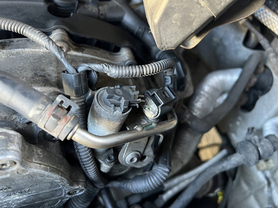

Well i went to unplug the N205 and you can see what happenend below. The plastic was already cracked to the point where i could see the copper before attempting removal and i suspect that it wasnt good before completely coming off.
I think ill start with this  :happy2:

« Reply #9 on: January 09, 2022, 02:24:00 pm »
Suspect that may well be your issue, lots of copper blue corrosion, so it's been cracked for a while - you may need to clean the loom plug.
I was intimate with mine back in the summer, at the time I thought it was a really daft design for the loom connection - with little or no gusseting to support, its as if they want it to break!
