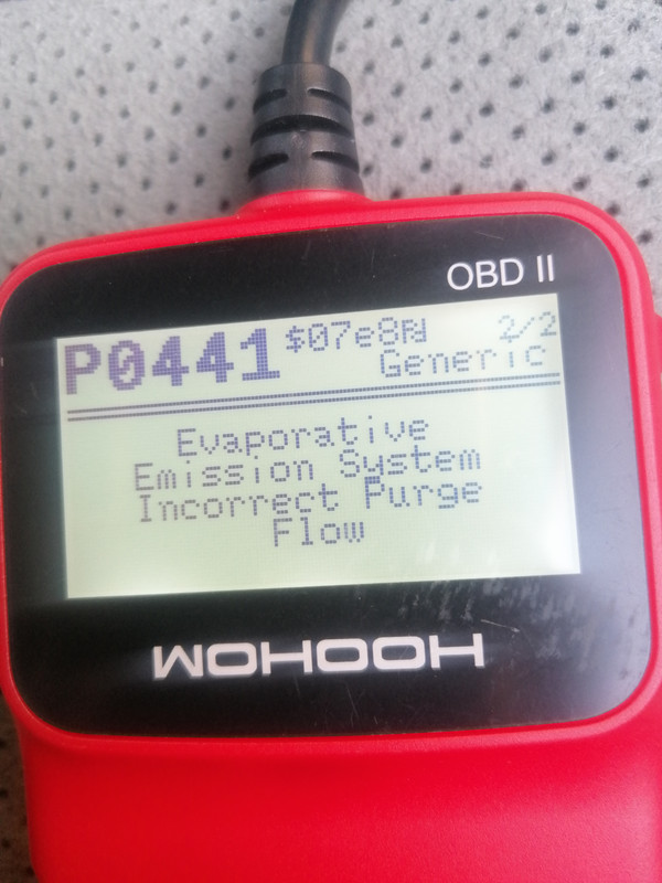

600 miles ago got a CEL waiting at a red light caused by the diverter valve, error: 'N249 Mechanical Malfunction'. My friend cleared it for me and it didn't come back since.
Now I got another CEL while also at a red ligt, and I scanned it with my cheap OBD scanner.
There was no change in performance or engine sound.
I cleared it and drove to work without the light coming back, nor any drop in performance.
Any ideas what it could be guys?  :smiley:

I lived with that fault for a while, you clear it, it stays away for weeks and then comes back - no real noticeable change in running.
It is either or both:
The carbon canister - it brakes down internally with debris going into the valve - ebay or amazon chinese ones less than £20
The N80 evap control valve - stopped working or blocked - OEM is made by Bosch and are over £70, but last time I checked genuine Bosch aftermarket ones £30 to £40 on ebay.
I hope the Octavia is otherwise behaving itself?

A bad seal on the petrol cap can also cause evap fault codes as well, believe it or not.   It's a very tightly controlled and monitored closed loop system, because......effin Brussels.
You might want to get onto that sooner rather than later as you don't get any fuel trims/adaptations whilst the evap circuit is flagged as faulty.

Cheers pudding, I sometimes too have doubts about whether to keep my VRS but then I remember that mk5 gtis cost ~€7000 and civics ~€9000 and both are uninsurable for me  :grin: nor are there any other petrol VRSs on the Irish used car market atm.
I've driven about 20 miles since clearing the code and it hasn't come back, should I wait until the code comes back again or is time to start throwing money at it again?
The petrol cap is a big wiggly when screw on, but I have nothing the reference off of. I did read that brimming the tank could also throw a P0441, which is what I did do a few days ago.

I had a similar issue with my previous steed, a BMW E39 530i Sport and I spent age phaffing in the engine bay changing hoses and ensuring tight fits then read about the fuel cap.  Instead of replacing I removed the rubber seals, put them in hot water for 5 mins and then replaced with some silicone spray which worked (well for about 500 miles).  After I bought a new cap on eBay and problem solved.
As @Pudding mentioned a slight inconsistency on the sealing of the cap can throw all manner of dodgy codes, very similar to a failing battery which still starts, runs the car with no visible issues and showing a good voltage BUT is still on it's way out.  Good luck.

I've heard that about brimming the tank but it's never happened on mine, and I do literally click the pump 5 or 6 more times after the first!
Check the cap seal for any obvious signs of damage but usually they look fine.  When I got the evap fault code years ago, I replaced the N80 solenoid - no change.  Changed the petrol cap - no change.  Changed the carbon can - sorted.
The problem with that fault code is it's not specific enough. The ECU just reports "incorrect flow".  Well that could be from a solenoid stuck shut (or open), depleted charcoal in the carbon can, leaking petrol cap etc etc.

Just ordered a Febi Bilstein 27288 fuel cap as it's only €8 off of Amazon UK. If it doesn't fix the issue I'll get the €20 Bosch N80 Valve off Amazon too. Hopefully I'm not starting another money pit here  :grin:

I drove about 100km before I put on the new fuel filler cap on earlier today. No lights so far.
Feels similarly wiggly to the old one so dunno if it made any difference.
Also did a longer, spirited drive after putting the new one on. Happy to report no lights, just loads of fun driving instead (and losing a rolling race to my friend in his 2015 GTD DSG :sad1:  :grin:).
A few ponies must have darted over the years methinks, or the octane booster isn't doing it's job.
