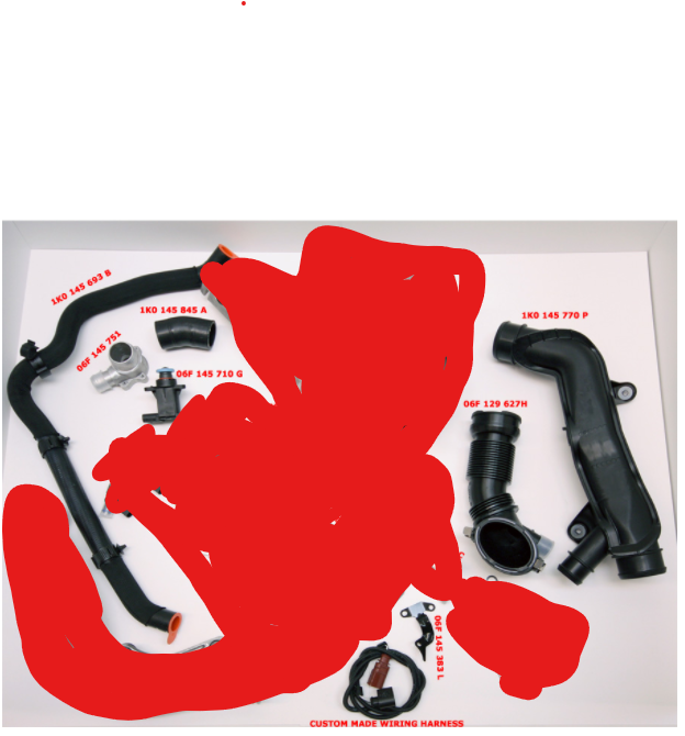

I relocated my K03 DV to the K04 location for ease of access....works well and is a cooler working environment for it.
That is interesting. Can you say a bit more? What did you buy - a kit or just the parts?
It cost me about £50 in parts from an S3 that was being broken.....you can use a harness extension, but I unpicked the original from the loom and relocated without issue......just time and patience needed.
I had to also get the alloy bung that blocks off the old DV hole in the turbo.
Had it all fitted about three years now without issue, and it definitely is a lot easier to check now
