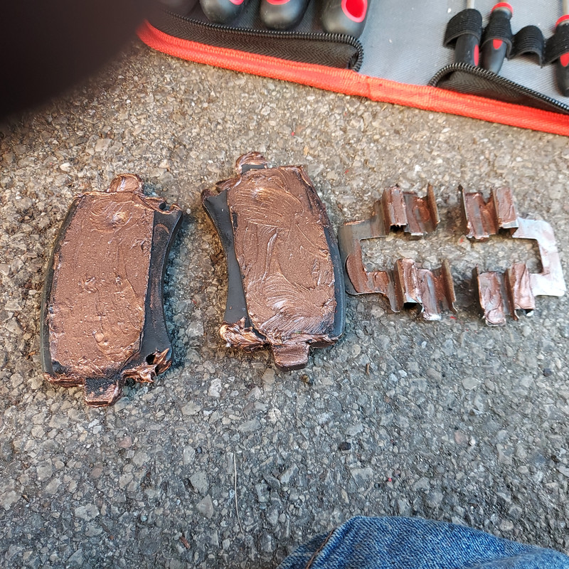

Currently changing suspension so while I was doing the rear had another look at the rear brakes.

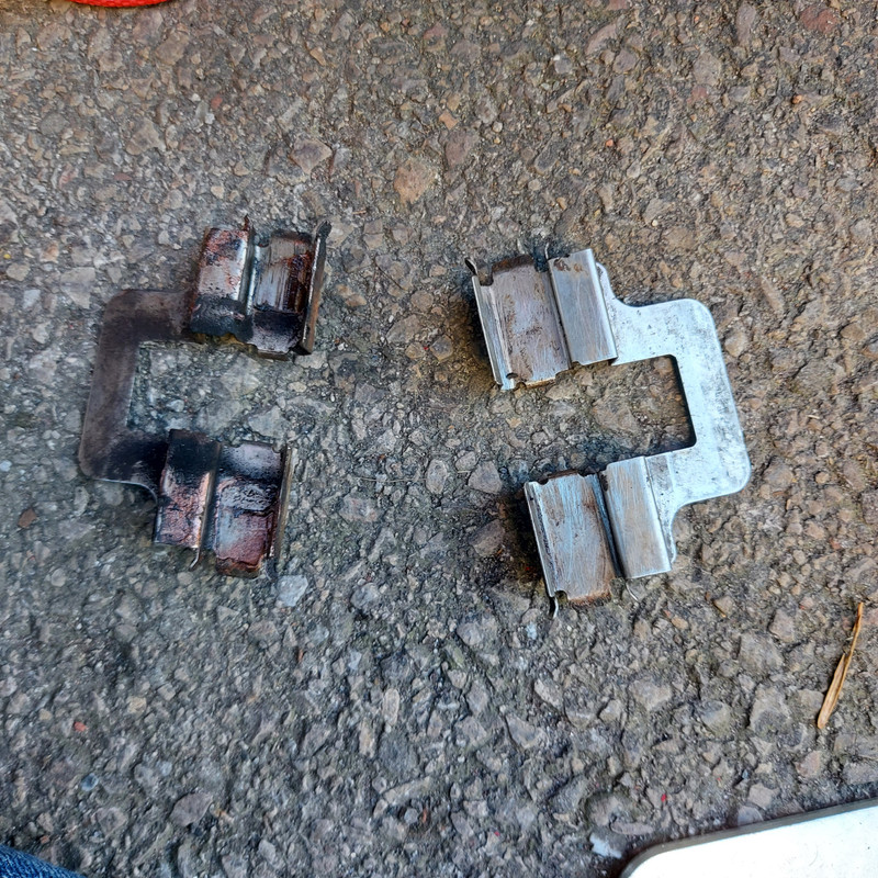

I decided to file down the shims this time. Left is before and right one is after.

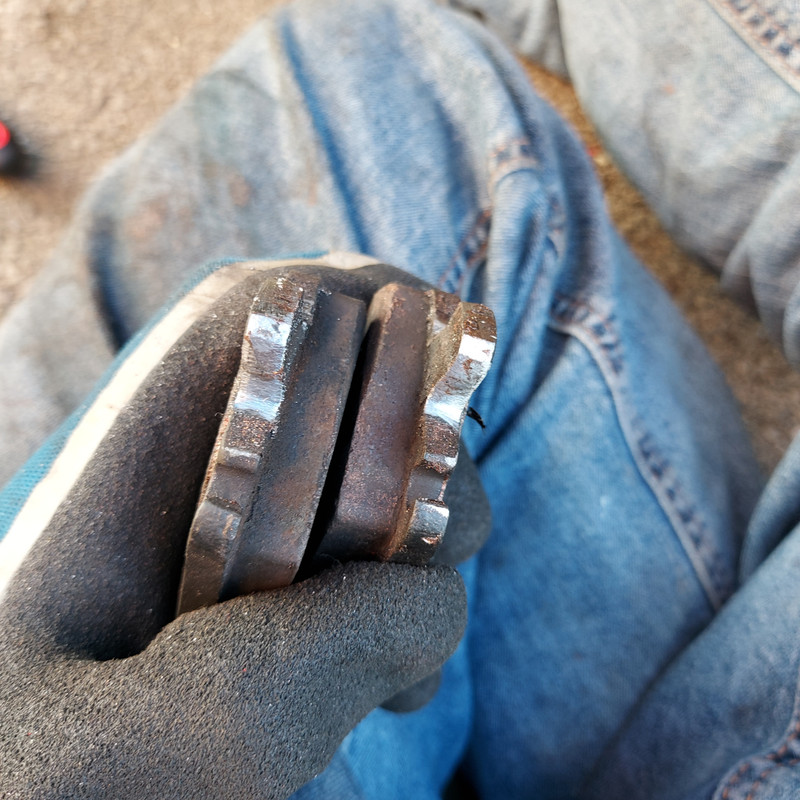

After greasing everything very well I tried to replicate with my hands the pads sliding down the shims and felt not so easy tbh so decided to file down the pegs on the pads about 0.2mm in width, they feel much easier to slide up and down the shims now but without any new unusual kind of movement.
Everything greased very well then as you can see
See how we get on with this when the cars supporting its own weight again. Need to also take another look at that handbrake lever on the other side as it is slightly different to this side I've done.
Not sure if this is a terrible idea with sanding down the pegs but seemed OK to me and frankly I will probably be changing them in a few months anyway if I've messed them up.

So just incase anyone comes across this in future and sees my modification and thinks " yeah that sounds a good idea".... don't do it :grin: terrible idea! Pad contact now is very strange it's touching the disk in a very uneven way as if it's got tons of grooves on the pad material and is obviously not sliding across and pressing firmly against the disk and at slow speed I can hear it dragging on the disk on every rotation.
