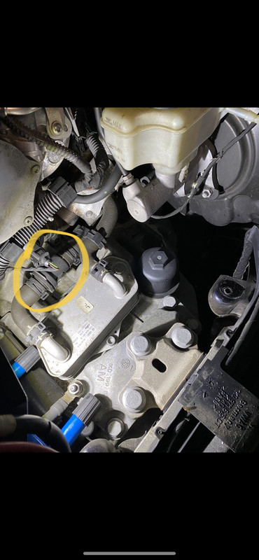

I have checked and i can see the inline Thermostat down past the alternator on the front of the engine. Jon is this the one you did without draininig the coolant? Im keen to drain it on my terms if necessary.
Ive messaged you about yours pudding.

Definitely check first.
Got that same T-shirt as Pudding  - buying 2x inline, not cheap - but my tame TPS guys took the spare one back.
The whole 1 or 2 inline thermostat thing for DSG cars is tricky.

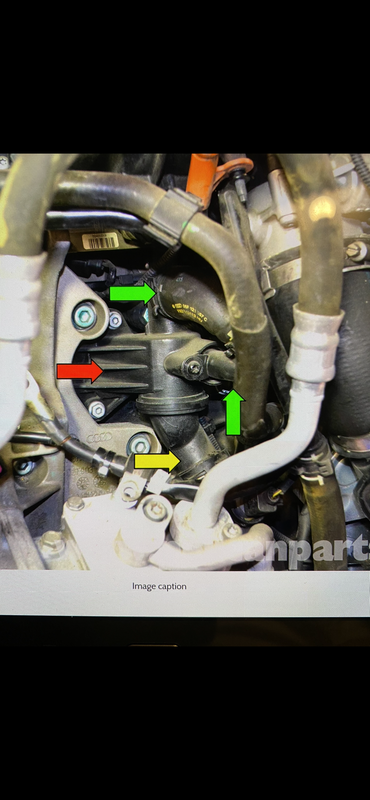

There is a good step by step on www.pelicancarparts.com for the thermostat
Also other interresting “how to” stuff for mk5  :happy2:
