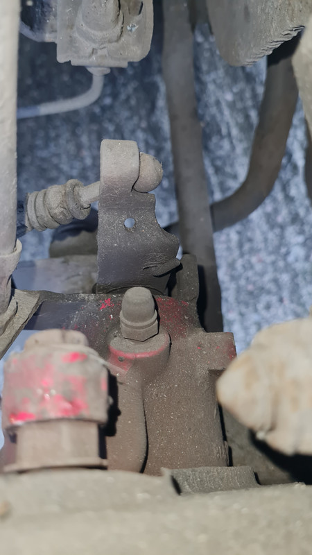

I'm having an issue with my passenger rear handbrake not holding the car. A few months ago on a trip back from London I notice a metallic tinkling noise coming from the passenger rear when the window was open at the back. When I pressed the brakes the noise went away but upon looking at the rear wheel it was black with brake dust and the rest of the wheels was fine.

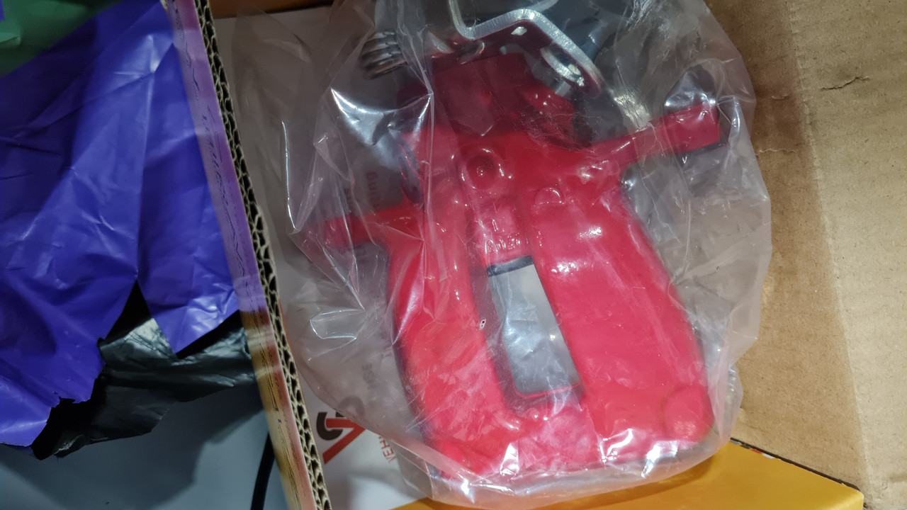

I've took the wheel off and disconnected the handbrake cable to make sure the lever is moving fine and seems OK with a pry bar. I've also bought a replacement caliper, brembo discs and pads all round as mine are well shot.
My question tho is if the brake dust is a sticky caliper dragging then why is the handbrake not holding it?. It will work if I really yank the handbrake on but not fully like it used to.
What do you suggest I check? I did have the handbrake fully on and when I cracked the wheel nuts the wheel still moved a tiny bit. Is it the handbrake cable too?
I'm gonna take the back wheels off and jet wash the calipers and surrounding areas then lube the handbrake lever just to check

There should be no more than 1.5mm on each caliper with the handbrake off.
I remember having to adjust mine when I changed the caliper and it not biting properly.

« Reply #7 on: February 04, 2022, 10:38:01 am »
So mines about right?
It's git the same gap as the replacement caliper I've got
Will take off the drivers rear tmr and see if they look the same

« Reply #9 on: February 05, 2022, 11:00:10 am »
So just tested the handbrake function and with the handbrake off, the wheel is binding to turn by hand. It looks like the outer edge of the the pads are rubbing on the disc inner lip.
I added a video of the hand brake moving freely. I'm thinking it's the discs and pads that need changing and if it's still binding then it's the caliper that need replacing too.
