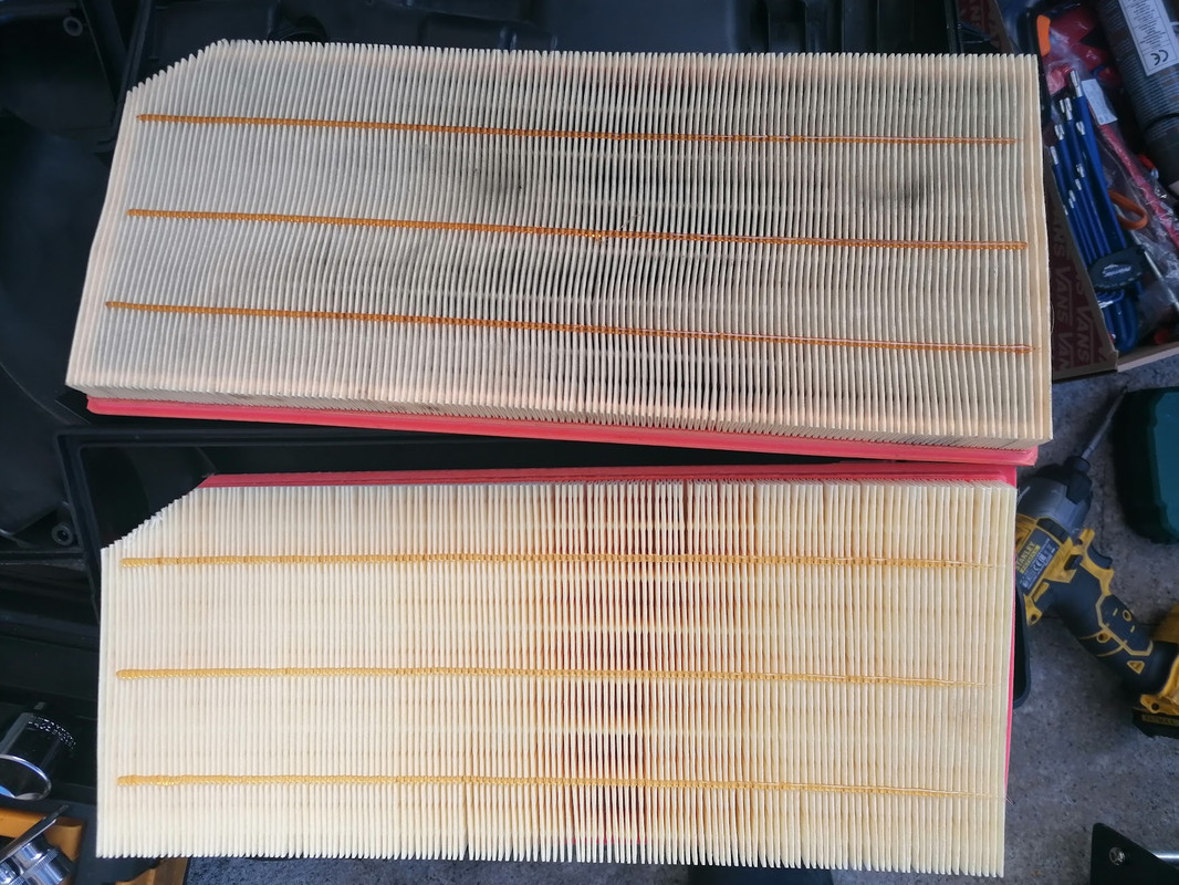

Little update, here's the new and old filter.
I got a WIX branded filter as that was the only brand that was in stock in the parts store (VW didn't have air filters in stock either). Coincidentally the same brand as the one that was already in there. Old one was much cleaner than I expected.

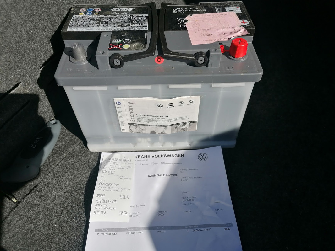

Also unrelated but here's a pic of the OEM battery that VW supplied, a calcium 72AH EXIDE Battery with dimensions 278x175x190.
I had no idea EXIDE was the OEM brand, It was €121.77 with a 2 year warranty so I guess that's alright. It's also kinda funky the way you see the acid splashing around as the casing is translucent.

That doesn't look like a filter that has done 27k.
