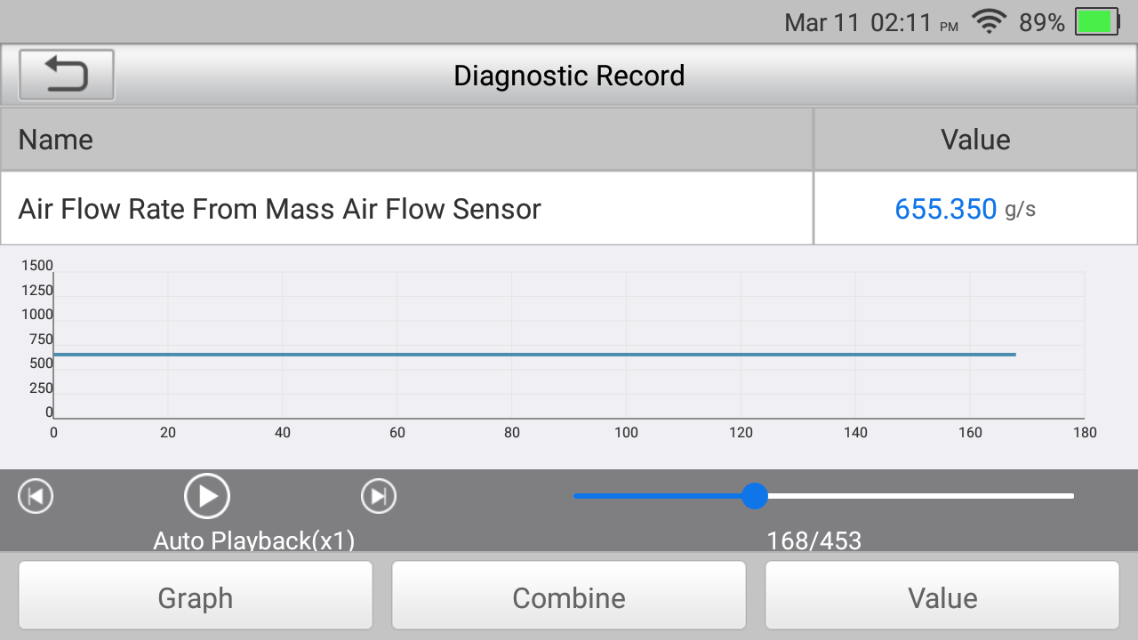

This is the data from a drive out I did while recording yesterday. Its just a constant 655 which would indicate its just doing nothing at all
Ryan

« Reply #9 on: March 11, 2022, 03:33:09 pm »
Yeah if the number doesn't move at all, definitely fooked.
I think there's only 3 wires on the MAF.  You could do a continuity check back to the ECU pins if you're bored?

I got 5v ish on the yellow wire, Perfect ground on the brown wire but no battery voltage on the black wire
Note I neglected to mention that I also had the following codes
01314
p0100
p2188
I didnt think they were important at the time, Turns out they were a big hint. I tested the black wire on the MAF to fuse 29 (I think) in the interior fusebox and got no connection. Turns out I had a broken wire right down in the harness below the battery which ended up being really hard to find.
