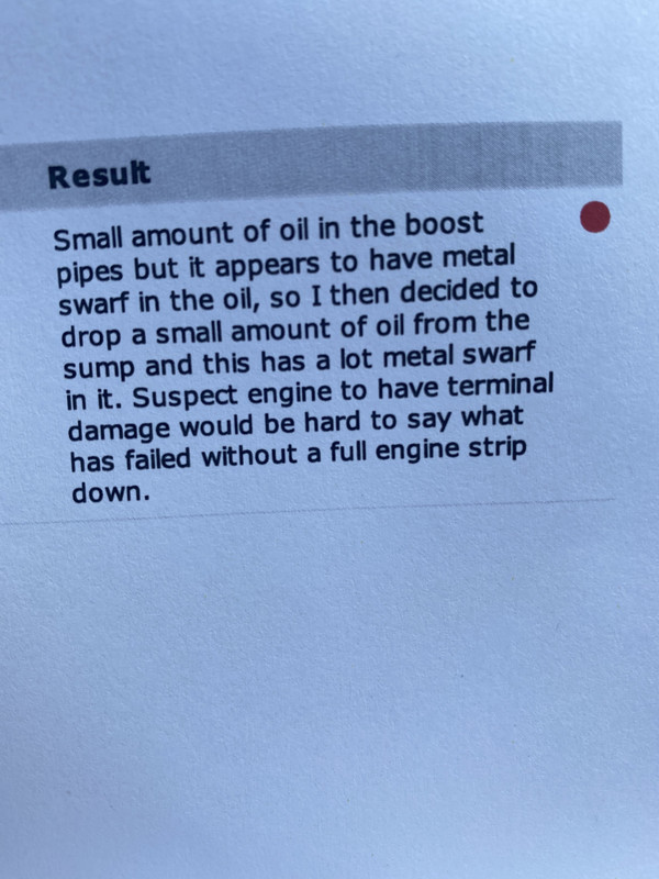

« Reply #4 on: May 20, 2022, 03:40:40 pm »
Not good news today..

Ask what colour the swarf is how much there is. If it's small gold/brass flecks, it's turbo bearings breaking up.  If it's silver or copper coloured swarf, that is engine bearings.
Hopefully it's just the turbo as that's an £800 fix plus labour, versus £1000s for a new engine/rebuild.

I’ll find out tomorrow

They’ve said it’s the engine and not the turbo, it was a mixture of metallic metal swarf

Bugger. Oil starvation by the sounds of it then.
