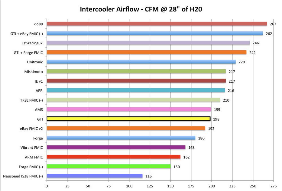

An S3 and Forge Twin-cooler does a very good job. So I'll post the following for your review.
This is just water flow testing results (not many coolers included)...it is not a cooling test, and note the Forge is done with the std GTI cooler. Also shows some that flow worse than the stock GTI cooler:

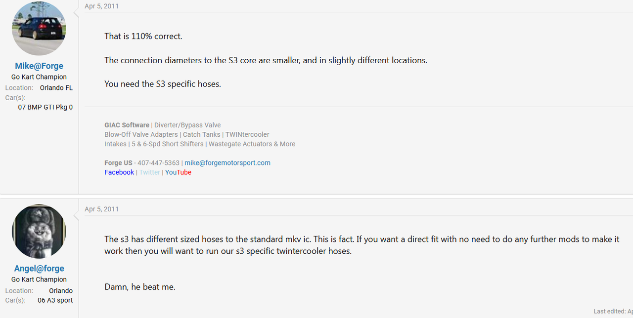

Just butting in, did the pipes on the forge twin fmic fit the S3 intercooler as is? Thinking about getting one but I'm unsure of how the pipes would fit.
Thanks
Thanks
You need to specify you need the Forge S3 hoses when ordered. The S3 inlet and outlet ports are a smaller diameter than the couplers fitting the stock OE fmic.

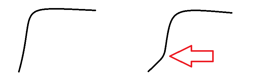

Regarding lag...they say this ↓ , but not sure if they are being honest or if this is a political statement:
I didn't notice a LAG feel with mine...but I added the S3 and Forge the same time as the K04.
I do know its actual boost will match its target/specified within 600 to 700 rpm when doing a data log run, starting the run from 2k or 2.5k rpm.

When I say lag, I don't mean nothing, nothing, boom, but rather a slight loss of crispness to the onset of boost.....if that makes sense.

« Reply #13 on: June 10, 2022, 05:15:25 pm »
Yes, I imagine a bit of a nearly impossible to feel delay...or a less immediate, snap-to-life feel? Yeah...I get it. When I saw the Forge response...I too thought they're not going to come out and admit something of the sort. And I had nothing to compare it to...having done all mine at the same time.

« Reply #14 on: June 10, 2022, 06:11:55 pm »
Yep, exactly that. Likely an immeasurable difference between GTI and S3 as VAG will have done their homework, but all the same, behind the steering wheel in the real world.....a slight feeling of less urgency when spooling up. Obviously once into the meat of the boost, all good  :happy2:
I did initially put it down to my swap to a MK6 gearbox possibly having taller gearing, but thinking back, it was the same with the stock trans as well.
Well, Forge are naturally going to say there's no lag with their twintercooler, but basic physics and facts would disagree. I guess some of it comes down to mapping. Kick the turbo in earlier to compensate for the bigger space it has to fill. I'm pretty sure that's what VAG did with the 6R/S3 by way of more intake cam lift/duration and more N75 lower down.  Dunno, just a hunch.  They do feel very alert and punchy low down compared to an OEM K04 GTI.
