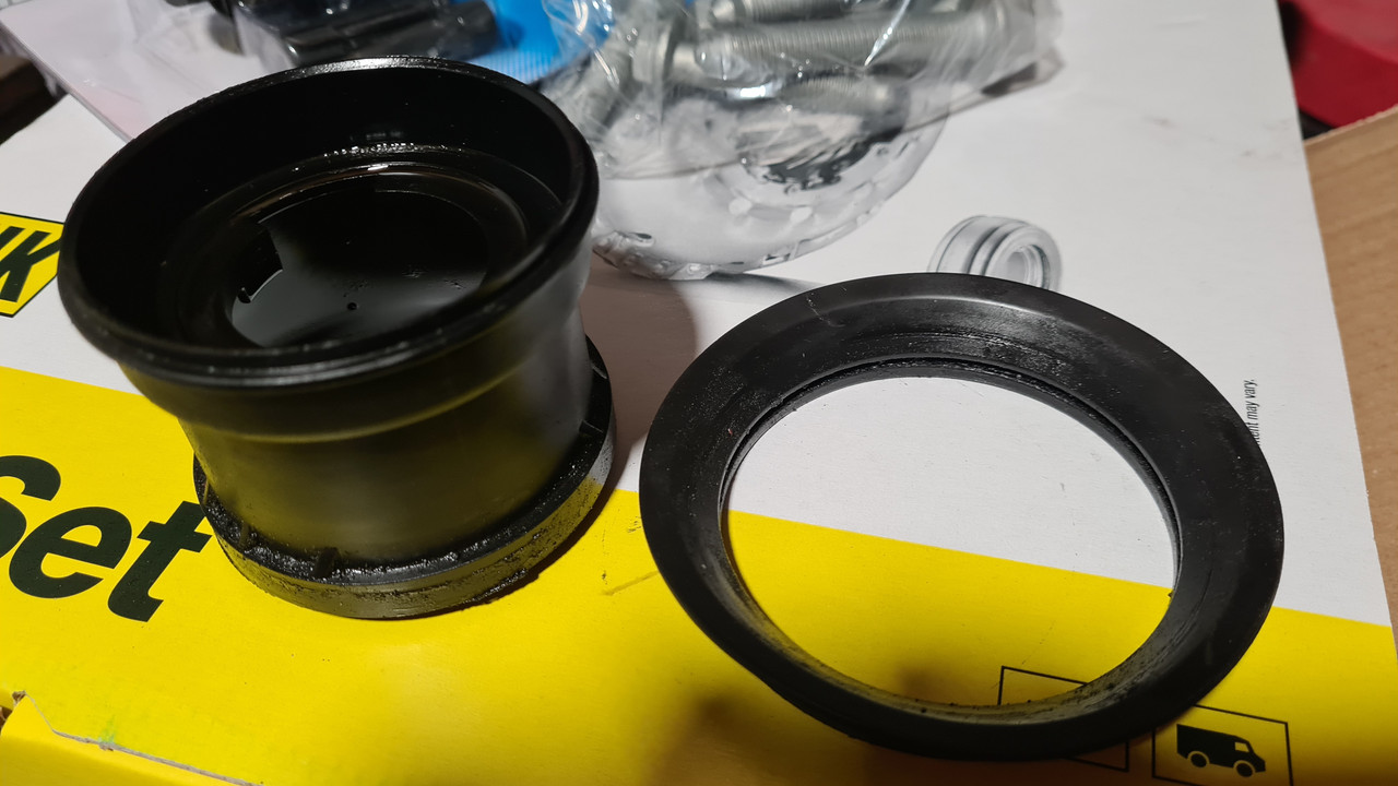

There are four seals....three are the same and one other small one up at the turbo outlet.
Excellent image - the green one at the turbo outlet is the one I was wittering about! - apparently K04's don't have this one
They most certainly do.  S3/6R intercooler upgrade does away with number 6 at both ends of the intercooler.
As I myself have been wittering on about, it's number 6 on the discharge pipe (part 9) that wears the most (because of all the engine rock), which also wears out the bore of said pipe as well, which no amount of new O rings will fix.  A new pipe is the only way to fix that particular problem.
