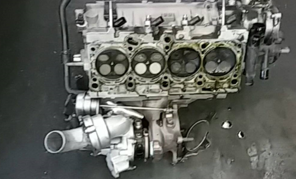

Mine started doing this seven years ago. Would make smoke when coasting in a low gear...then started smoking when rolling from a stop after making smoke when coasting. The smoke and oil usage kept getting worse and worse. Finally oil loss was at 1L/800 miles. I thought it may only be the valve stem seals and guides. So I planned to have the head rebuilt. Upon removing the head, there was a bunch of oil in the #3 and #4 combustion chambers. So those two pistons were removed and we discovered the rings were stuck in the piston grooves. The rings came out of the #3 piston but would not come out from the #4 piston. I replaced those two pistons, all of the rings and rod bearings. The head was rebuilt with new valve stem seals and guides, as the seals were hard and brittle and the guides were worn. You might consider removing all four plugs to see if any are coated in oil. If yours is anything like mine was...there will be oil on them or if any look different. But they may show no signs. Because as you can maybe see in my pic...the plugs aren't dark like the rest of the combustion chambers.
This was right after the head was removed from mine:
