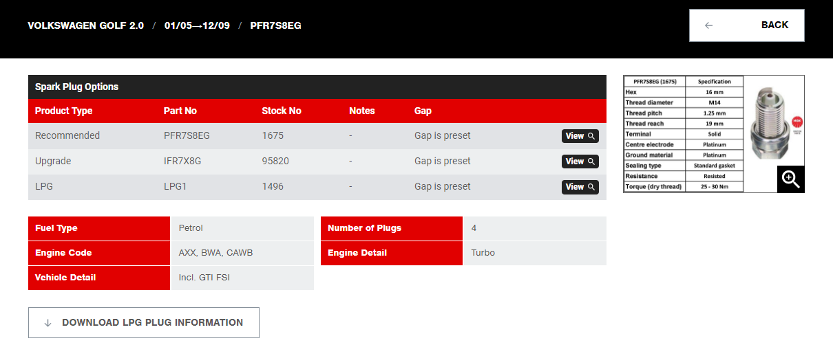

Yes get that impression a lot.  Looking on the NGK site there also appears to be another Iridium plug offered: IFR7X8G that has a similar spec to the BKR7EIX
https://www.ngkpartfinder.co.uk/catalogues/cars/search/spark-plugs/VOLKSWAGEN/GOLF/2005/14571/
Mike
South Coast

« Reply #14 on: July 08, 2022, 01:58:34 pm »
Interesting, haven't seen that one before.  NGK consider it an upgrade (over the PFR7S8EG)......probably because it's Iridium. Not cheap at £16 each though  :grin:
It has a platinum pad on the ground strap, which makes it an upgrade over the BKR7EIX  :happy2:   The BKR7EIX just has a plain ground strap, so won't last as long as the IFR7X8G.
