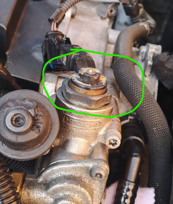

Tbh I knew I'll need one at some point anyway, as the current pump plug has just been glued by a previous owner/mechanic (photo attached).

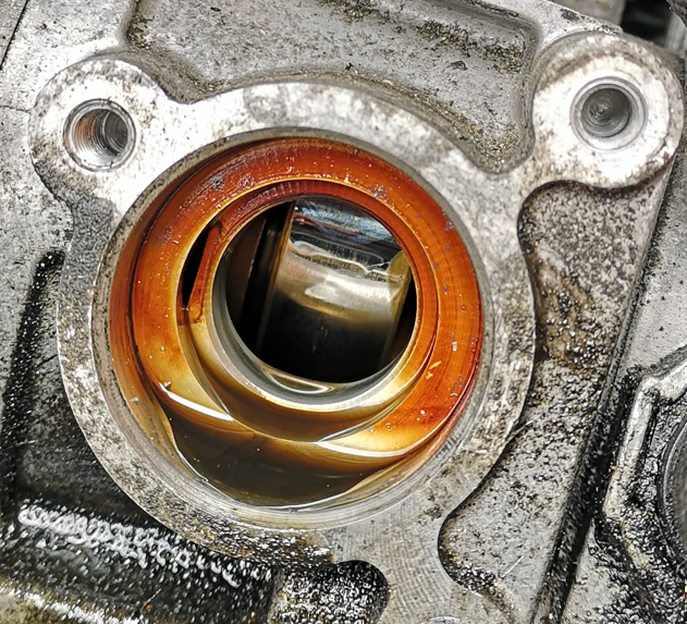

Right now I've completely snapped off the Schrader valve, so obs its not driveable, but the nut part is still stuck.  As you can see from the 2nd photo, the brass just gets chewed up and the mole grips slip off - which is how I snapped the valve off.
Annoyingly I still cannot get to the T30 bolt with my current tools, so this may still be stuck also.  Any ideas how I can get the remainder of the Schrader valve/nut off?

Time for a new pump.  The thrust sensor on the top is damaged (common problem) and not available separately, and the drain/pressure test valve is fooked as well.
You should be able to wrestle the torx bolt out far enough with grips and just hacksaw the bolt head off and start over with a new bolt and pump  :happy2:

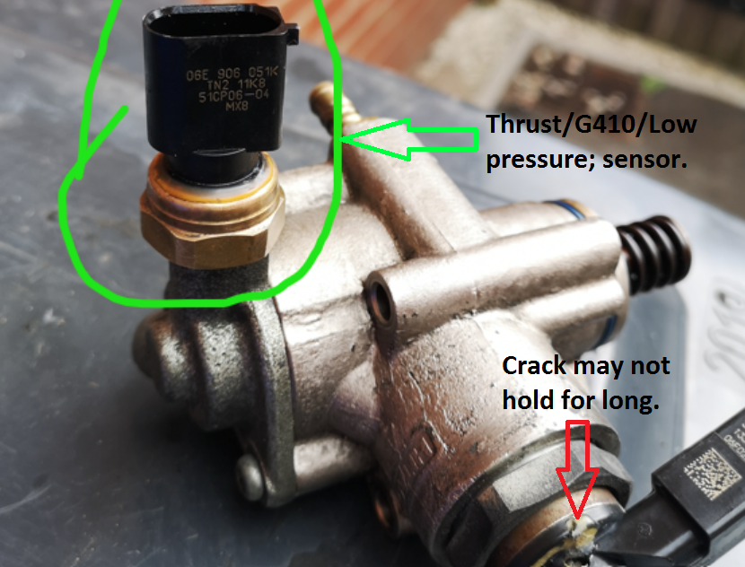

This is just FYI...not intending to be a 'smarty pants'  :wink:; on top is the rail pressure regulator valve or N276. The Thrust sensor or low fuel pressure sensor (G410), is on the side of the hpfp.

If you're changing the punch just hacksaw off the brass which is in your way. You can always extract it later on a bench/vice.
That t30 doesn't look too badly mashed, carefull application of pressure should get it going slowly with a rachet. Sometimes the torx Allen keys are a bit better than bits for stuff like this. You could hammer in a t40 and get it out or hacksaw a slot and use a big flathead to get it moving the torque isn't that high.

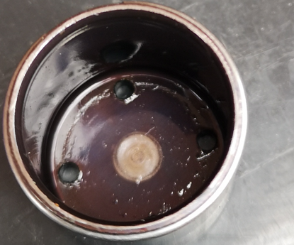

Its off! The torx bolts were actually ok, the one that's a little smooth/rusted was the tightest but came loose without problems.
The main delay was taking the hose off, but that was just because its an awkward clip and the pliers kept slipping - then I remembered I have mole grips  :stupid:

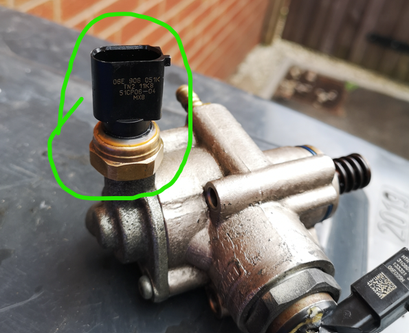

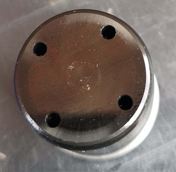

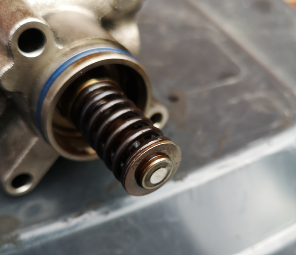

Attached are the photos - after all the effort I think everything looks OK (the cam follower looks really marked in the photos, but is smooth to the touch).
For the thrust sensor, I guess its the entire unit, so I remove the brass fitting from the HPFP - does anyone know the part number for the O ring?
For the HPFP, a site has this description for a genuine VAG part - as mine is a 57 plate, I guess it will fit as standard (I assume the old HPFP fittings were with the banjo bolt)?
"This is the latest revision of the 2.0 TFSI high pressure fuel pump. Standard factory internals. If you have an earlier car/pump, you may need to swap the brass fittings"

Blue o-ring pn: WHT005184
Cracked N276 valve, when it fails, requires a new HPFP. Because the N276 isn't found and sold separately.
