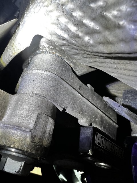

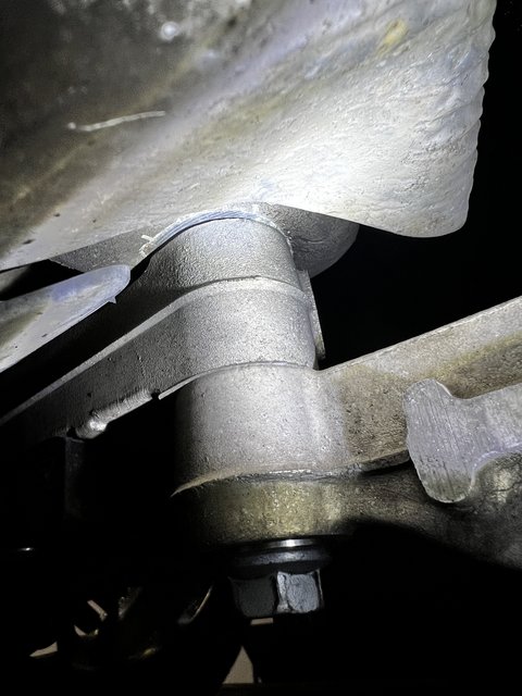

The shiny areas are just where the subframe used to sit.  The dead set kits realign the subframe holes to be dead centre (hence their name) which will naturally repositions the subframe.  When these cars left the factory, the subframe could be a few mm over to one side compared to another one. They literally threw them up to the floor and worried about the alignment afterwards.
Subframe position really doesn't matter though, in terms of alignment.  At the end of the day, all they can adjust at the front is toe anyway, which is pretty rudimentary for any alignment shop, or ought to be at least  :happy2:

Hey Kev,
That makes so much sense now, and i understand what you've explained - Thanks mate!
So Jordan at Gatwick Tyres (fellow petrol head) adjusted the alignment. He did say that it looks like Kwik Fit may be using an older version of s/w on their hunter, which could account for the issues i've had. However he tweaked the settings and asked me to drive it over the weekend and see how it is. Whilst its a LOT better, the steering wheel is still slightly off centre and still pulls to the n/s, so going back tomorrow for hopefully the final check and alignment. I've added a pic of the existing set up.
