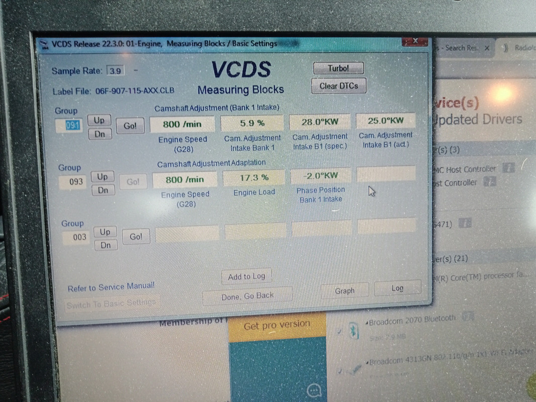

Well I've made some progress!!
Using measuring block 93. When it's cold (no noise) the spec. is 28 degrees KW. Actual is rock solid at 27.5 to 28KW.
Once it warms up the actual starts to move between 24 and 28degrees KW. As it drops to 24-25KW this corresponds directly with the noise.
So. Could this be the oil seals in the variable cam timing module? As the oil thins (with temperature) this causes the instability/variation between 24 and 28?

I think that's my next plan, open the variable cam timing cover. The VCDS interrogation shows that the chain is in good condition but I'll check/replace the oil seals in the module.
Plus do some research into how it actually works to try and figure out why it's unstable.
