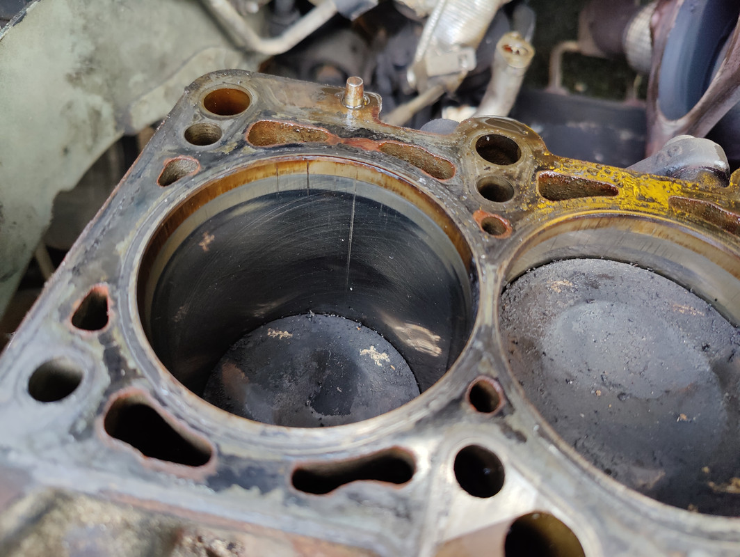

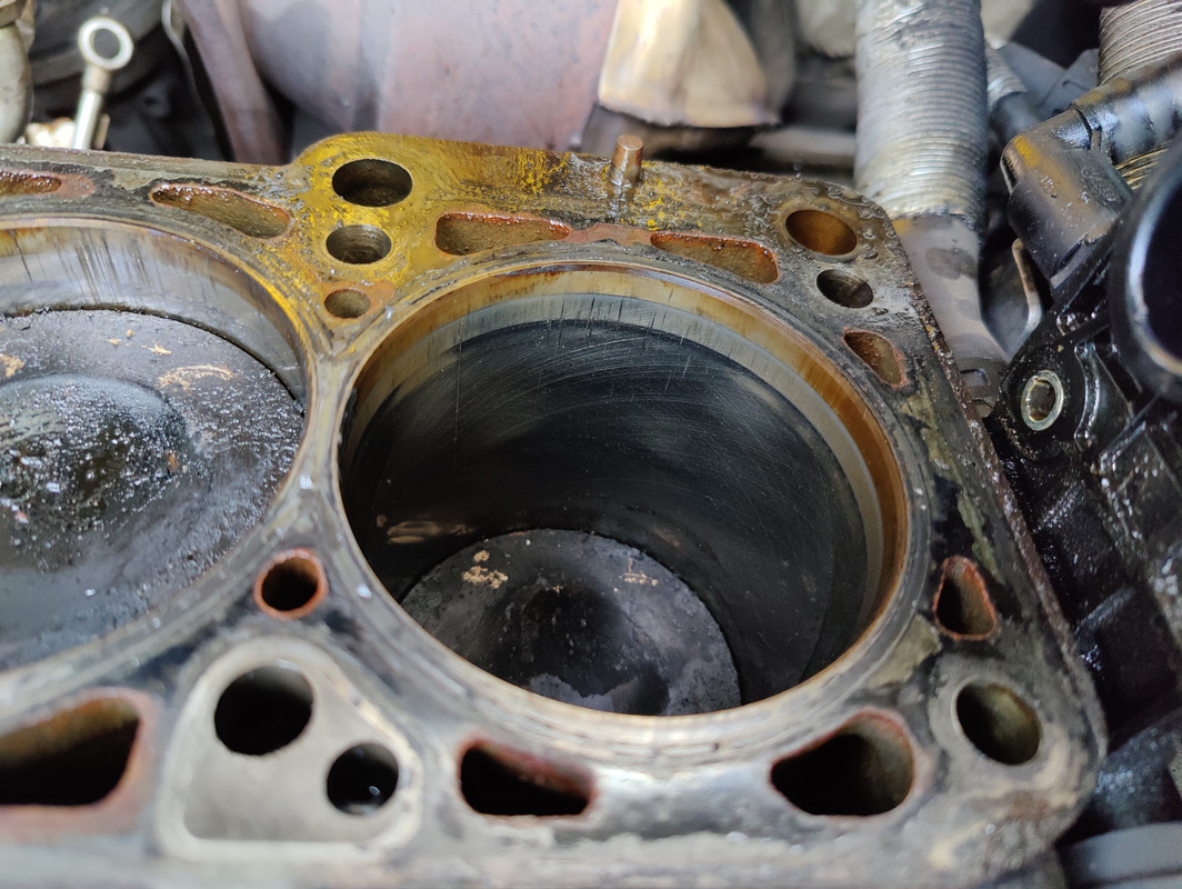

I recently had my cambelt snap on my mk5 gti while I was driving. Started the teardown process to see how bad the damage was.
I've just got the head off today, and obviously almost all the valves are bent (as expected), but more worryingly, there is some significant scoring on the clyinder bores.
This is the first time I've had the head off since owning the car, so no idea whether this damage was caused by the valves hitting the pistons, of if it was there before this... event.
I'd like to know what people think in terms of the severity and whether there's anything I can do. I know it's hard to tell just from photos.
I suspect I need a new block, but would be very happy to be told otherwise!
Thanks in advance
Note: I had the cambelt changed 15k miles (2 years) ago by a garage, but I'm not convinced they fitted the correct belt from the state it was in when it came out.

I am sorry to say the scores in the bores don't look good - if you can catch a finger nail in the scratch it is too deep.
With them being bright steel, they look fresh - if they were old I would expect some debris in the scores. actually, looking at the No.1 the score continues under the tide mark at the top of the bore, so it looks like its been there a while.
I experienced a belt fail - the valves just hit the pistons, nothing falls off unless you dropped a valve.

The scores on 1 and 3 fail the fingernail test miserably unfortunately.
Appreciate you confirming what I already suspected would be the case!

Scratches like that normally happen from overheating.  The piston ring gaps close up and they have no where to go except up or down, which breaks the ring lands, or expand outwards, which scratches the bore.....or a combination of the two.  Pretty common on remapped engines (most folk don't realise they are driving around with broken pistons until it starts smoking badly) but it never happens on standard engine unless cooling issues occur and it over heats.

As far as I know car isn't and has never been mapped, but that is very interesting as I had an overheating issue previously due to dead radiator fans, so could well have been the cause!

how was it running before the cambelt went? burning much oil? noisy ? down on power ?
grant you the bore scoring is far from ideal, but it didnt happen just at the point your cambelt let go afaik.
