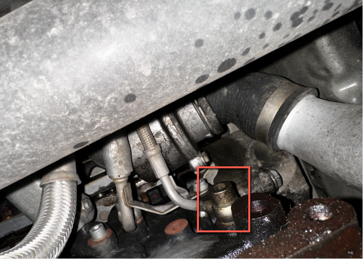

Hi, I have remnants of an oil leak in a specific place on my sump, anyone who is more knowledgable on these cars have any idea of where it seems to be coming from?

it looks like its coming from above the sump
Could be cam cover gasket, possibly turbo oil feed, but you need to get some brake clean in there to see where its coming from.

Looks like the seal on the turbo oil outlet to me.
The banjo could be loose or the copper washer has given up.
Thanks I will get it cleaned up and have another look.
Regarding the oil return feed is this the one?

It may be the oil feed......odd angle to get my bearings
This one
