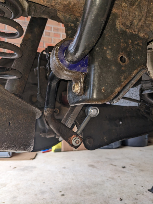

Fitted the new bushes (SuperPro) and drop links (Lemfoerder) to the rear anti roll bar.
Had to lift up the rear arms using the trolley jack to get the new drop links to line up with the holes nicely, but apart from that it wasn't too problematic. Well, that and not knowing how to pry the old bushes out of the brackets, but when I figured out to pry from the top it was easy.
I think the anti roll bar itself has seen better days.
The rear does feel firmer (as is my usual preference), so I'm glad I did it. Thanks for the recommendation.
