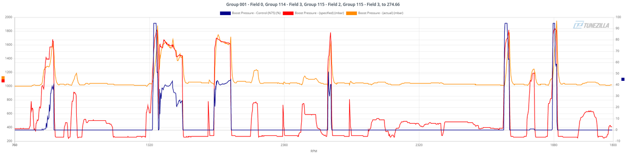

I did some logging and wanted to ask if this looks right to you.
 link for detailed logging:  https://log.tunezilla.com/chart/665195#H8KLCADDp2fDsmMCA03CjUsKw4MwDETDr8KiwrUFDcO0NsOGC8K1EcKuw4DCscKCwqzClDTCp28+JGQzwot5w7PCmBjDocKtw4NLKmM2wp3DhgbDocKRw4JWFjVZGAJQKWtmwq5sw6QMB8KtXzZHV8KcwpFmw5nCrMODwqPCvsOHw59VwoFJw77DuMKuNMO2G8KIw6sYwrodw5DDpMOaw4Yifl51w4/ClMO+wp3DhH/CosKXAAAA
I’ll be honest I don’t understand these readings. Hopefully someone on here who knows what they’re looking at can tell if those values are correct.
« Last Edit: February 19, 2023, 06:41:04 pm by GreigC »
