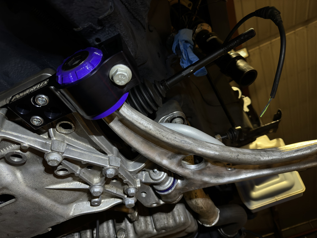

Over the last few months I had been gathering parts to give the front of the car a major overhaul which included all new bushes, bearings, brakes and suspension components. I also had a rattle coming from the front of the car that sounded like it was coming from the steering rack, due to this it was the perfect time to install a refurbished rack while everything was off the car. I also stripped both front wheel arches and the underside of the floor back to bare metal to make sure there was no rust and also keep it nice and fresh as I daily the car in the salty Scottish winters. I used buzzweld zinc primer, buzzweld stripe coat and finally tintable Upol Raptor.
List of new parts installed:
Powerflex anti lift kit
S3 lower wishbones with superpro bushes
S3 Alloy hubs with new FAG bearings
S3 Lower ball joints
New track rod ends
CVP Subframe deadset kit
Refurbished Gen 2 steering rack
Powerflex steering rack bushes
Whiteline adjustable anti roll bar
Vibra Technics subframe bush
New dogbone mount
MK7 GTi Performance Pack brake calipers
Pagid discs
Ferodo ds2500 pads
HEL braided brake lines
Motul RBF660 fluid
BC Racing drop links
OEM brake disc guards
All new bolts and screws including c clips, arch grommets

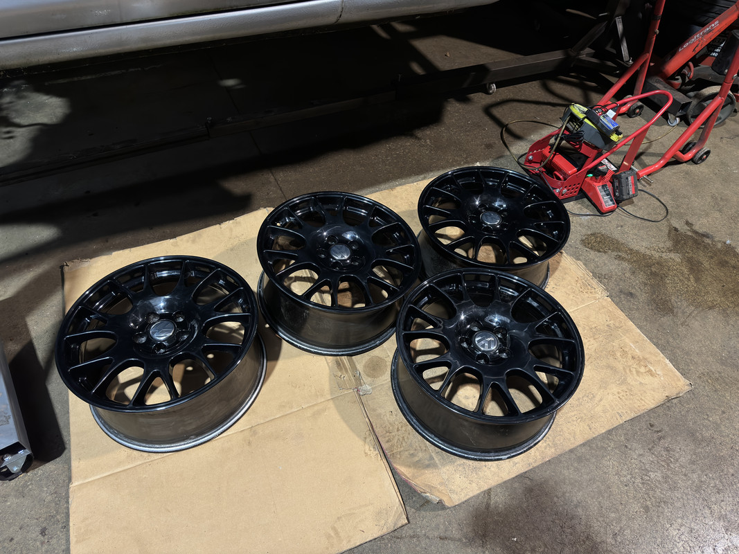

Also managed to pick up a set of genuine BBS CH028's in good condition. Was going to get them refurbished as I don't really think the gloss black goes with the graphite blue but this will be a job for nearer the summer.
After installing all of the above the car handles so much better and the stopping power is incredible. The noise/vibration is definitely noticeable after installing the vibra technic bush but isn't horrendous.
