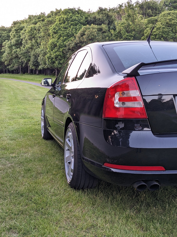

Running 18" Crystal Silver Bola B1s on my VRS, I can confirm you need spigot rings, if you're buying them new send them a message that your require 57.1mm spigot rings. The ones I got with mine were plastic pink ones.
'06 Skoda Octavia vRS TFSI
