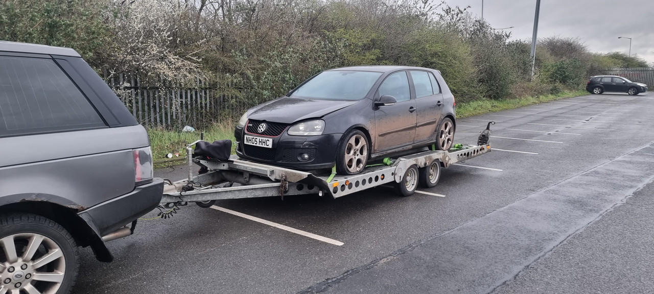

Picked up a golf recently with suspected cam chain failure as its spins over however there's no fire or no compression. Had one guy who was helping me fix it n he's just gone quiet on me with helping me fix it so fixing it myself.
Decided easiest way to deal with this is by fitting a 2nd hand engine. I've already ordered a new cambelt kit, service kit and cam chain kit.
Anyone know what the cost of replacing the cam chain is labour wise. I'm capable of doing it myself while the engine is out however I'll need too cough up for the locking tool and the cam shaft socket. I know this is going too cost the wrong side if £250 just in parts so I'm wondering if its just worth while too make it someone else's problem.
Any suggestions or thoughts
