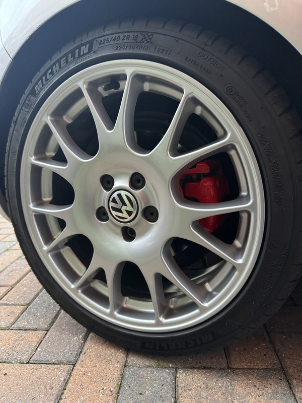

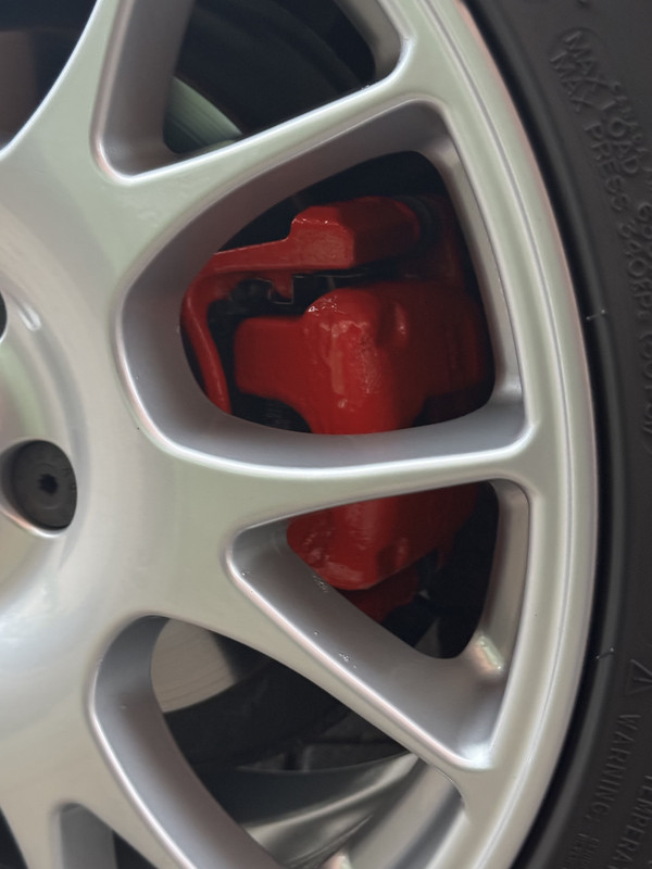

Nice, cheers mate. Aye I was unsure which ones to go for on the front, I’ll be honest I thought that the golf R and the R32/S3 setups were the same! Where did you get the GTI decals from? Just eBay?
Got my front’s all painted up ready to fit, along with drilled brembos and matching pads, I’ll get round to getting them fitted soon!
Rear brakes have now been done, the drivers caliper was seized and that was what wore the pads down, all stripped, cleaned, painted and re-assembled, I did buy discs but to be honest the discs were pretty much brand new that were on it so I’ve kept them for another time. Also took the time to clean and ceramic coat the wheels while they were off.

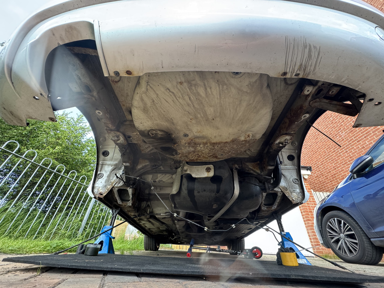

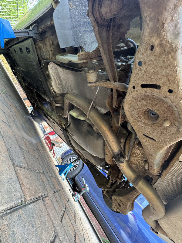

« Reply #41 on: June 07, 2026, 06:21:12 pm »
And so it begins……..

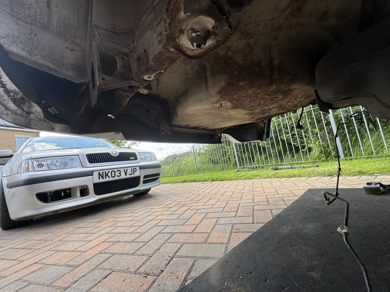

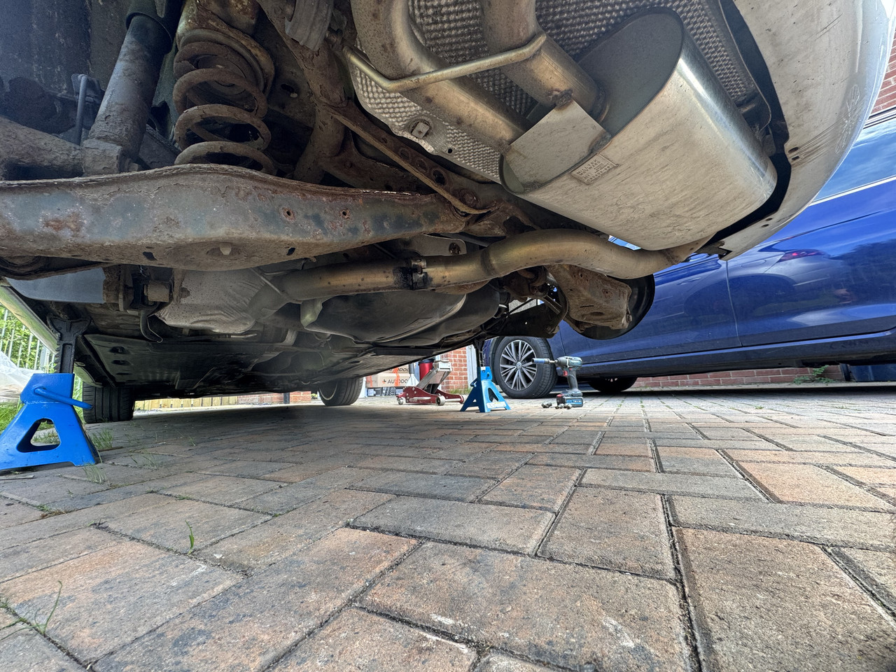

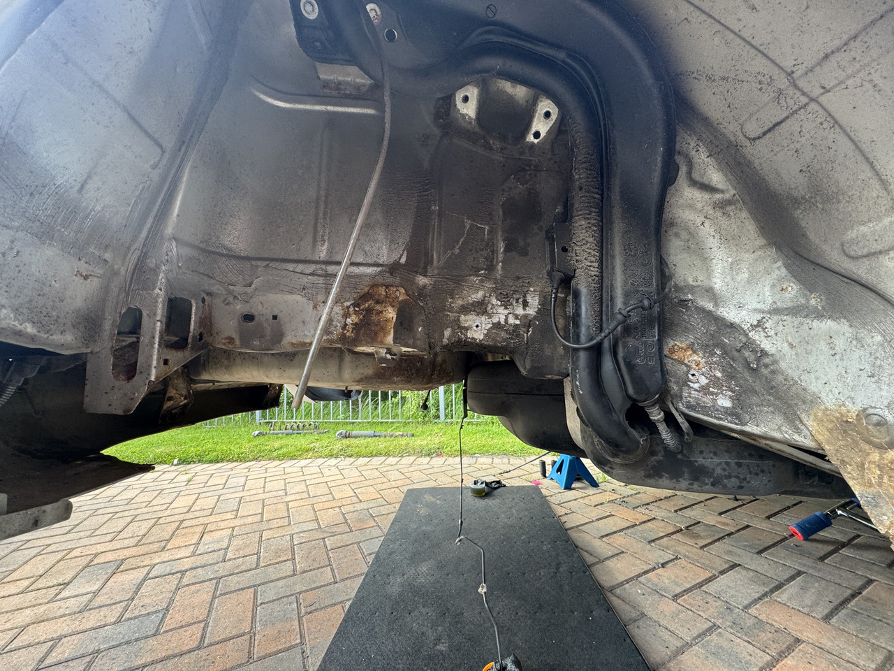

Plan is to get everything on the body buzzed down with a wire brush then get it coats with Bilt Hamber deox gel, then zinc primed and back to silver when required.
Bought all new Febi arms and everything, wheel bearings, basically everything needed for the front and rear refresh.
Will post more pics on here as I get on

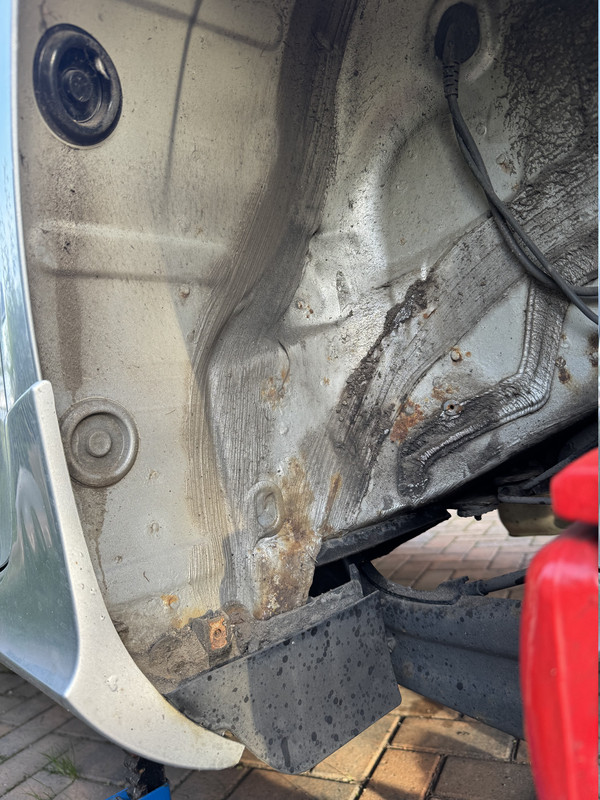

Offline mk1mad
  • Posts: 161
Re: New Member - Newly Purchased ED30
« Reply #42 on: June 08, 2026, 12:30:54 pm »
Got to to do the exact same job on my Edition 30, be interested to see what you find rust wise and how you get on.
Like you I will use the bilt hamber rust remover, I'm going to bare metal my inner arches and any rusty areas of the boot floor and then paint with a 2K epoxy followed by raptor . You can get it  all in cans now. That will be a better job than the factory did.
How's the mk1 ? is that finished ?

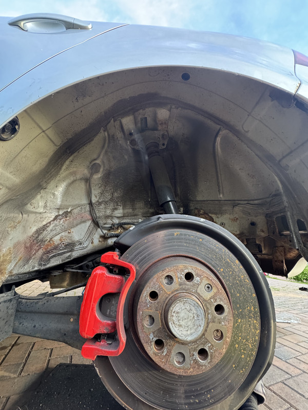

Offline Graney_ED30
  • Posts: 53
« Reply #43 on: June 09, 2026, 05:34:01 pm »

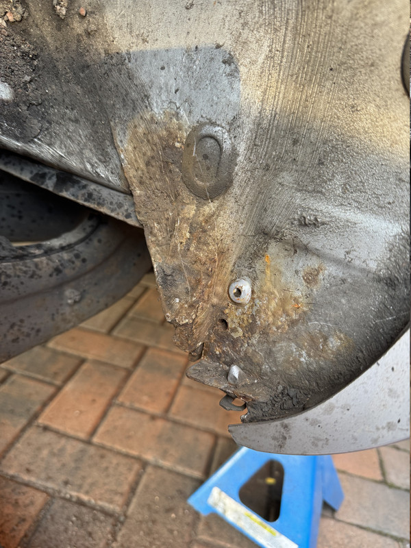

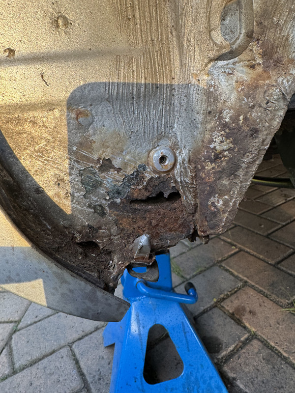

Aye mate, pretty much the same craic like, get it all clean and get it zinc primed and painted up.
Only found a small hole at the moment like so im suitably impressed…..the arch liners were holding a massive amount of mud haha!
Aye MK1 has been “done” for a while now, it needs a few bits still as they always do but I’ve done about 2000 miles in it since I finished the conversion, hasn’t skipped a beat tbh

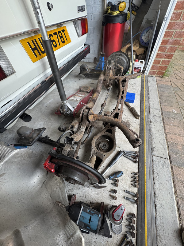

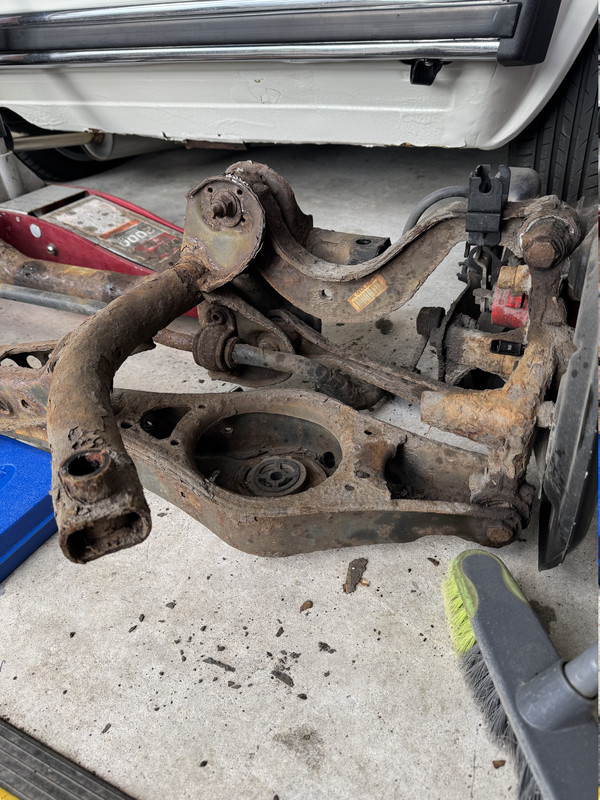

Offline Graney_ED30
  • Posts: 53
« Reply #44 on: June 11, 2026, 10:55:31 pm »

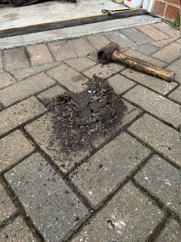

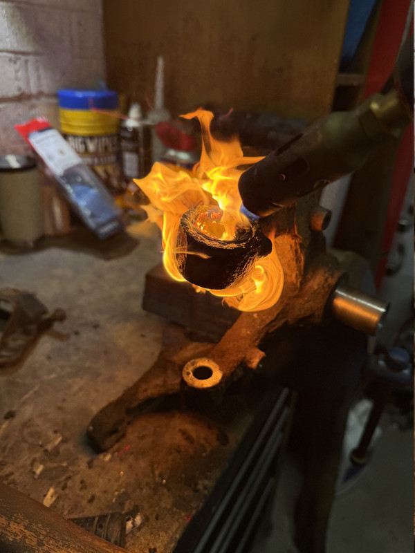

Well, got most of the bits stripped off the old subframe….the amount of surface rust that has come off is mental, but it still seems solid enough
Getting everything to the powder coating place hopefully tomorrow or Monday and then while they are away I’ll crack on with the rust treatment/undersealing/painting of the body.
Also got to order the rear brake lines as both of them just crumbled at the rear 😭 Hopefully still available, if not I’ll make some but I’d like this to be OEM fresh as possible

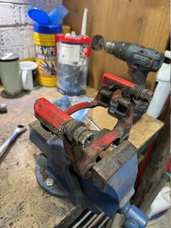

Probably just going to do the rear calipers myself tbh, I’ve got access to a blasting cabinet to get the thick of the corrosion off and then I’ll just get some new seals and slider pins for them, then get them painted up
Will get some more pictures up when the light is a bit better 😂
