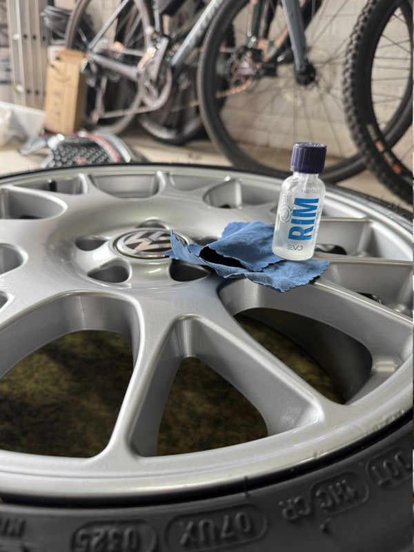

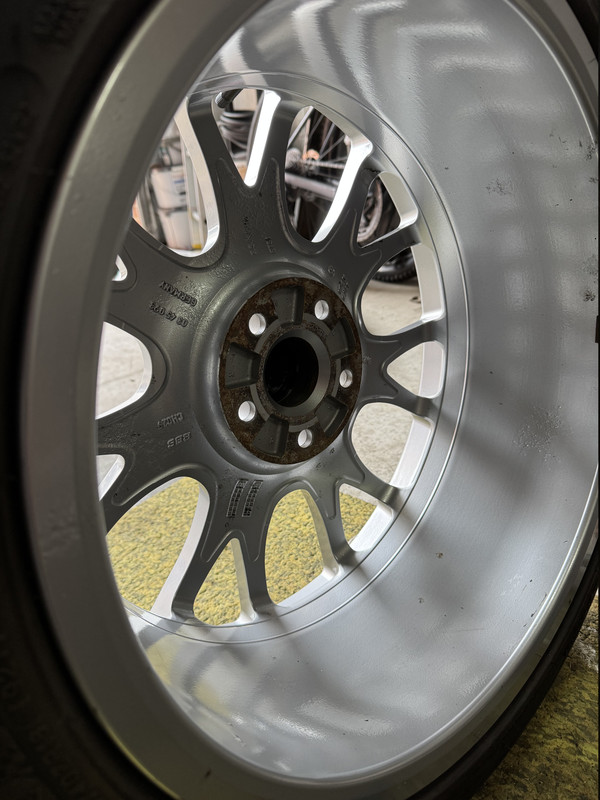

Stripped and cleaned the wheels team also ceramic coated them for future cleaning ease

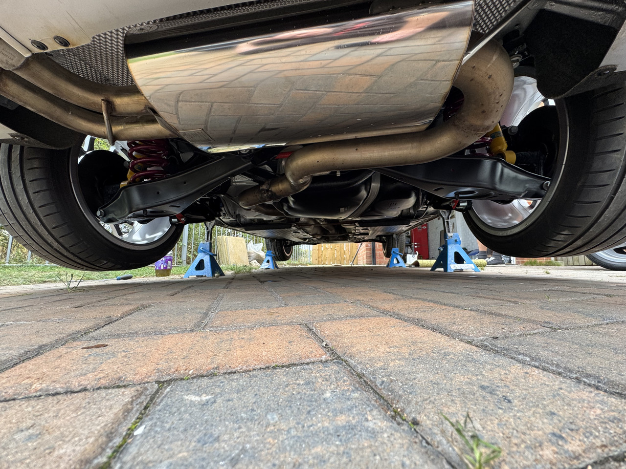

Completed underside at the rear

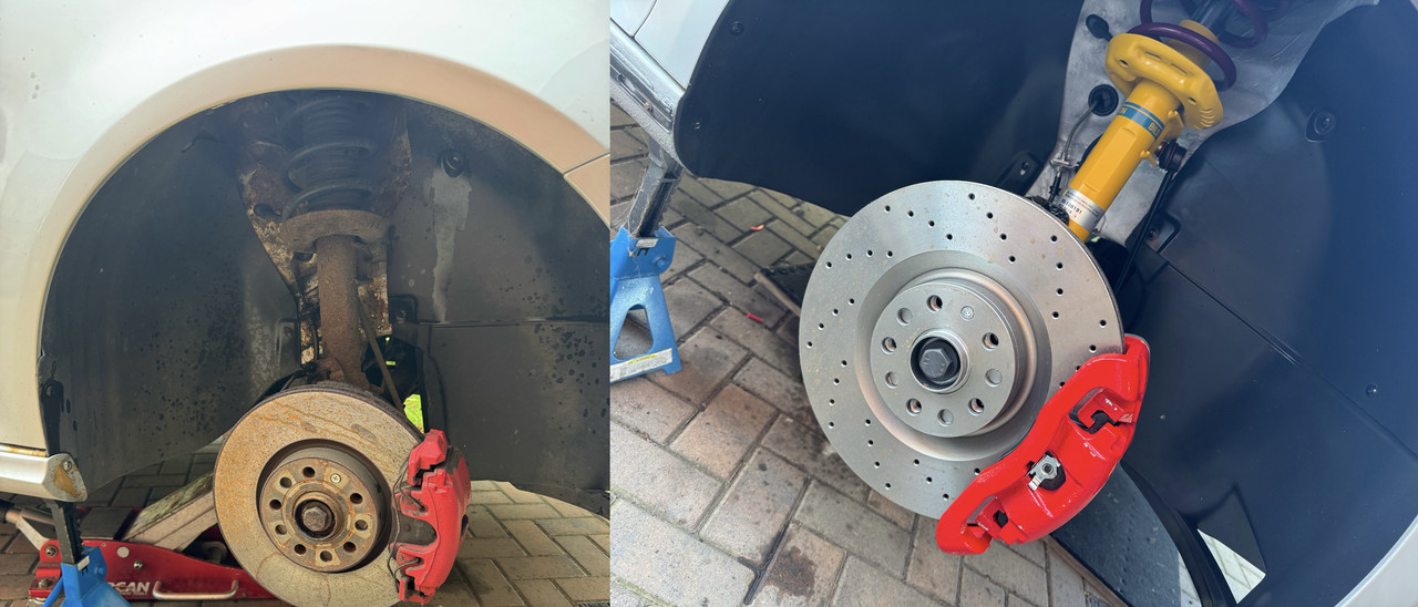

Nice little before and after of the front:

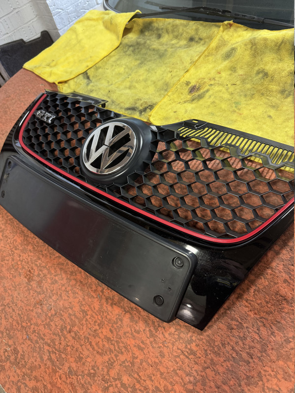

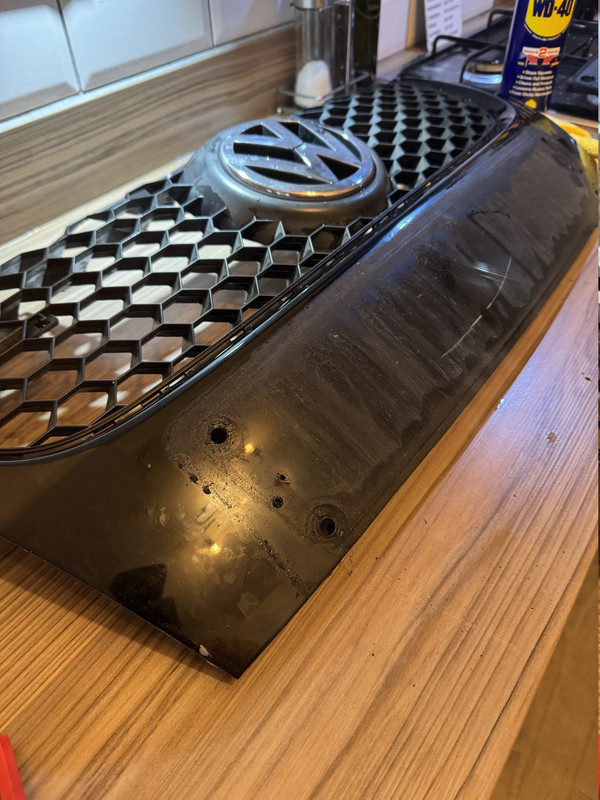

Also cleaned up and fitted a new front badge to the grille
