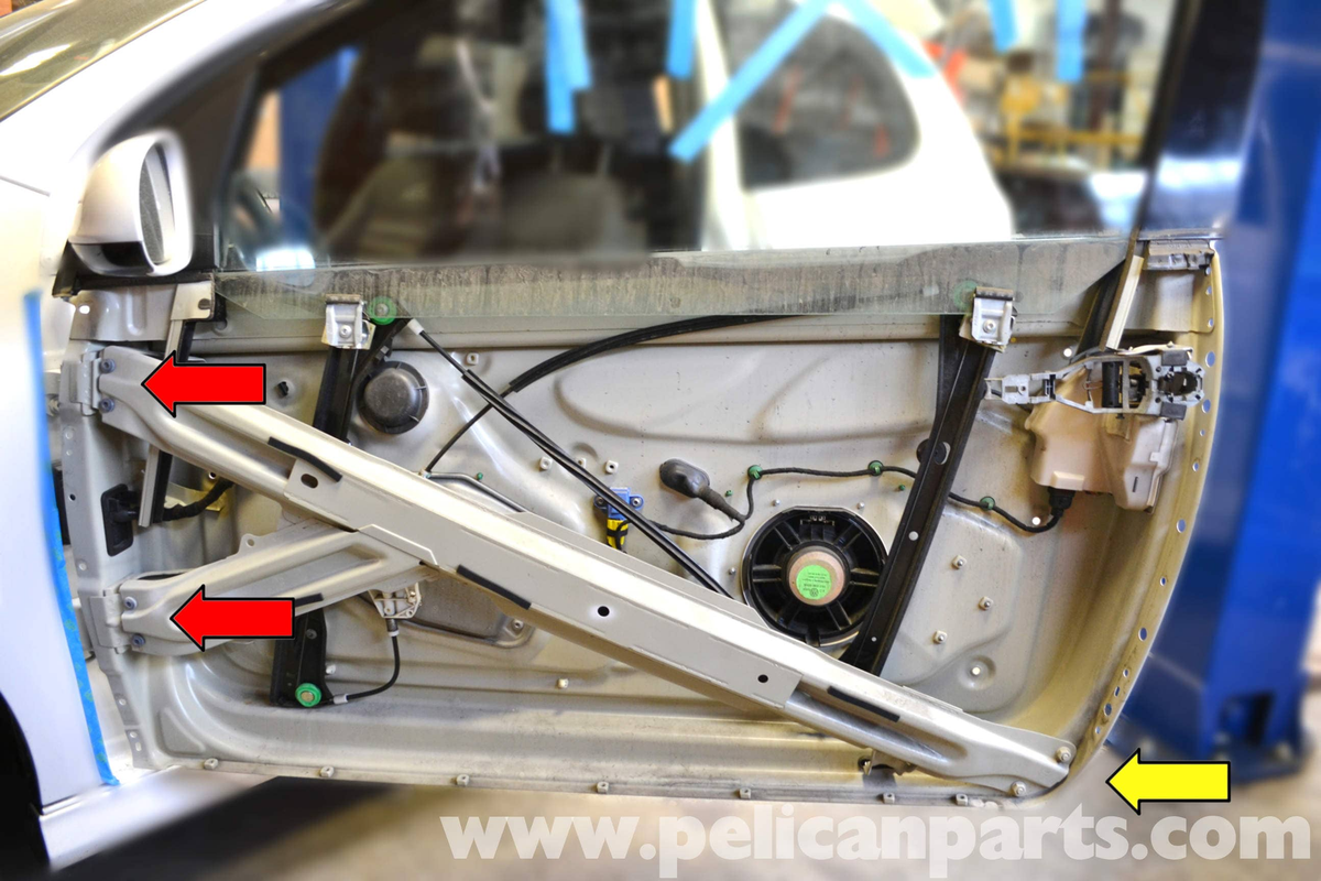

i=oB08DxEU3b3ntmqG
Follow this guide then you can focus on the window regulator once the door skin is off.
You won't see anything taking the interior door card off other than a speaker :)

I've done this job more than once on a few VW's and Audi's and I'd advise buying the entire regulator as an unit (already built up) they're cheap enough and it makes the job ten times easier than having to fiddle about with the cables and new clips etc.
Loads of youtube videos showing how to do the job. It's pretty straightforward. The regulator is bolted behind the inner door panel, you'll need to take the door card and the inner panel off to access it.
