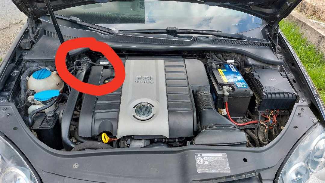

Hello dear members ,my Edy is an European model Left Hand looking to get an Intake System but I have to relocate the Diverter from before the Amplifier box to the front like the R20 and Edy's past mid 2007, I got the extra hoses but do I need a different body for the Valve or its the same like those infront of the Intake Manifold and its just plug n play in the Charge Pipe on the front!Thanks in advance.

Are you sure it's an Ed30?  The K04 doesn't have a DV in it, so all K04 engines have the relocate as standard.

Yep genuine Edition 30 with BYD engine K04 from Italy rust free ,the DV is separated from the Turbocharger but its behind the Coolant reservoir also connected to the amplifier tube which is something typical for the Left hand drive models, cause the brake servo is on the other side, its a stuppid decision from VW that means only hot air is recirculated.
