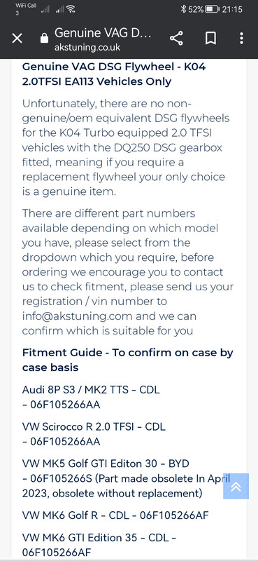

This issue applies to K04 engined DSG cars only, engine code BYD. Unfortunately it seems if you need to replace your flywheel you could be in trouble. The part is no longer available from VW and there doesn't seem to be any aftermarket options.
AKS tuning state: VW MK5 Golf GTI Editon 30 - BYD - 06F105266S (Part made obsolete In April 2023, obsolete without replacement)
Mine has developed a bit of a rattle and I'm guessing one of the damping springs have broken.
Does anyone know of a solution or does the Audi S3 flywheel fit?

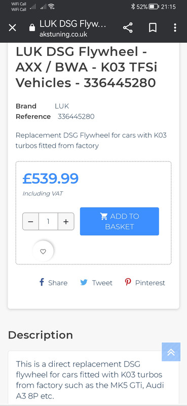

The GTI K03 cars share the same DSG gearbox flywheel as the K04 cars. Also they are available online from various companies.

I'm confused. AKS site say's they're different and the are no aftermarket flywheel options for K04 engined cars with DSG and genuine ones are no longer available.
