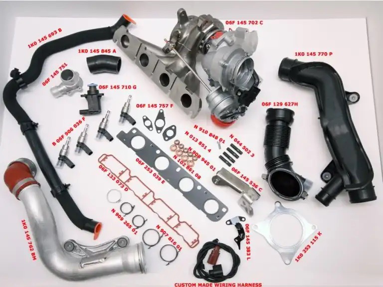

Hi, What are the part numbers needed for the K04 dv relocate only?
thanks

1K0 145 770P
1K0 145 693B
1K0 134 845A
06F 145 751
06F 129 627H
Custom made wiring harness
