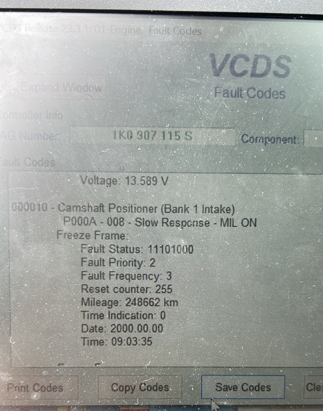

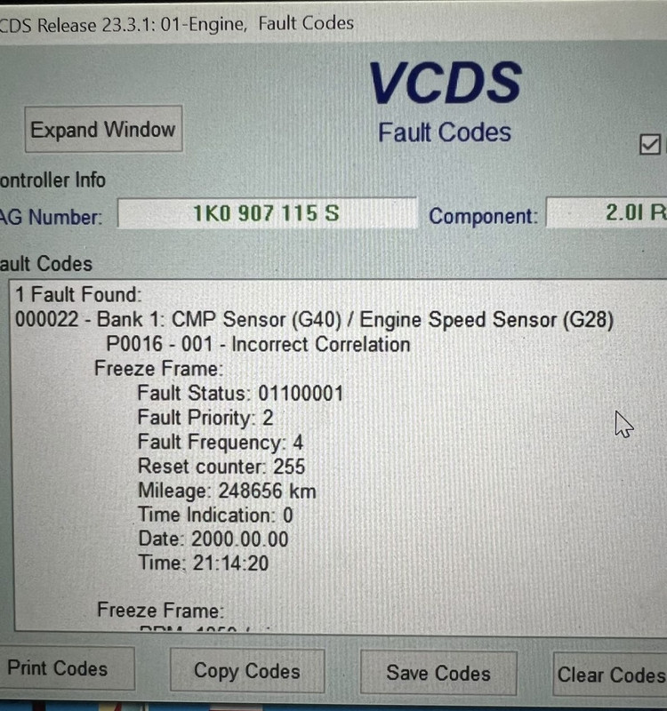

Hey guys, I need some help, recently I did a full head rebuild on my car(valves, intake cam, guides, seals, etc) replaced timing belt, camshaft chain tensioner, and also swapped the turbo all at the same time. After I drove the car for a bit I got a CEL , these are the fault codes I got, any ideas what might be going on? The car starts and drives fine. I’ve replaced the camshaft sensors and checked the timing on the belt and it looks fine.

Wanted to add after I replaced both crankshaft  sensors the second fault code (the one that mentions engine speed sensor) went away, but the one that says camshaft positioner bank 1 is still present  :thinking:
